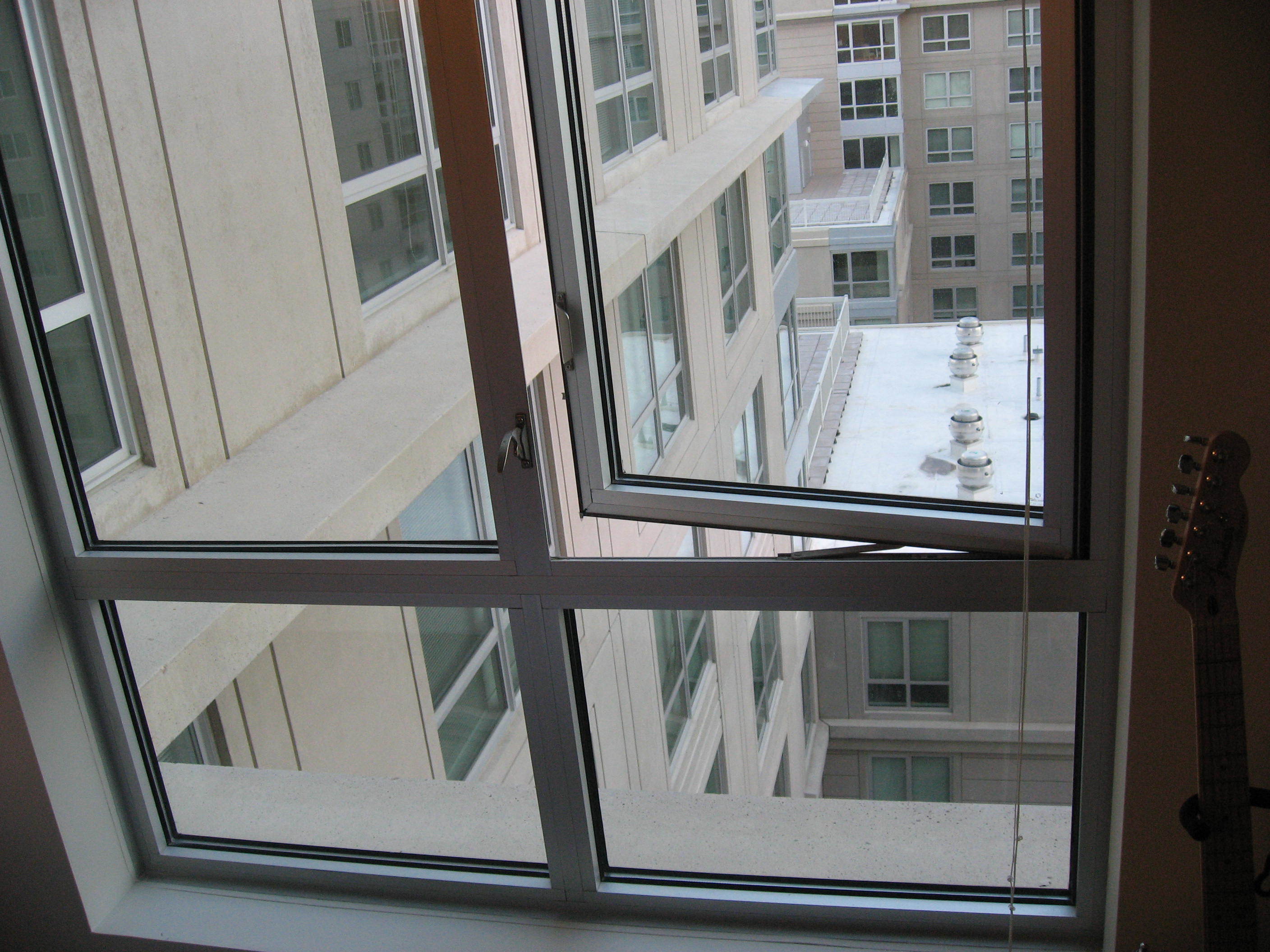

Im on the 12th floor of 13 floor building... i cant replace the windows cause im renting the unit, its not mine.... they are double paned glass. I do have a ledge outside my window, so if the dish is thin enough i guess i could squeeze it out there. Here is a pic of what it is, with the one window that opens, and that is all i can open it. So even if i could get the dish on that ledge, i dont know how i could mount it since i cant get out there. Any ideas with this?

well I have a friend with a T55 indoors, its a pretty funy sight, here is what he did
he opened the window all the way, took that plastic you use in the winter to prevent drafts, the stuff like suran wrap that you use a heat gun on. he put that on the inside and the outside, creating a double pane plastic window, perfectly clear, and works awesome.
not many choices
If the leasing company or landlord is real nice... you might put it on the roof above your apartment, and drop the cable down one floor.
(I'll give you about 0% odds on that, unless your family owns the building or manages it)
No way they're going to let you attach a dish to that ledge - you don't own/rent -it- , so you're pretty much out of luck.

First, check if you have a clear line of sight to the satellite you are interested in.
What is the hight of that window? If it is 28" or more, you should be able to fit a dish through it (diagonally). Then you can mount the dish on the outside of the window using the window ledge.
Yea its over 28 inches... so i would be able to mount it, even if i cant get outside there? And im not sure what u mean by a clear line of sight to the satellite i want. Im new to this, so i dont know much except that i need the FTA receiver and a dish. thanks
