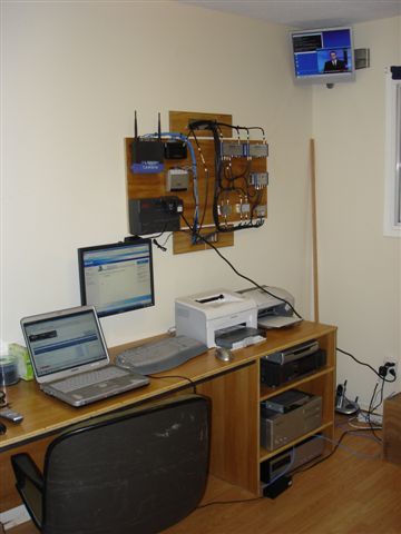

here is a pic of my setup, 16 runs into the house :) I dont have a pic of the outside right now, but it all comes into the house in 2" conduit for easy changes.
I wish I could do that. Right now I am running most of the cables into the slot where my A/C stuff comes out of the house. I have thought about drilling a bigger hole but the issue was the drop ceiling that it comes into. Plus the TV is right above the hole where all the cables come in right now.

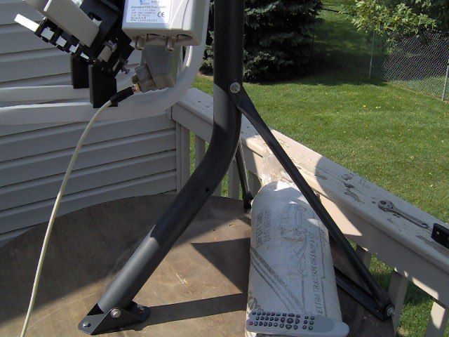

These switches are pretty well built. see the below picture. 2 of them are these and the other 2 are the old 4x4 multiswitches that they used for DirecTV Phase II which were designed to be mounted on the back of the dish. So I might just seal them with the coax seal.
I've had some troubles with signal strength fluctuating, now I'm starting to wonder if I've got water inside of my diseqc switch. I have all of my dishes mounted on top of my wooden storage shed. It actually wouldn't be much effort for me to drill a few holes and mount my switch inside the shed instead of leaving out out in the elements where it is right now. Before I go through that effort, I'm thinking that I'm going to spend the $5 and buy a new diseqc switch from my local store to ensure that I'm just not mounting a water-filled switch inside instead of outside :)
I have a switch that has been outside the whole time (3 MN winters going on the 4th)
The Diseqc switches I have mounted under this table so they are out of the elements but the 4x4 switches are underneath the dish bolted to the top of this wooden table (I wish I could get pictures of it to show what I am talking about). Originally I was going to run the 4 diseqcs to a 4x8 multiswitch in the house but that doesn't work so I have to put the 22k switches first. Maybe I'll just seal these up and lay some plastic over it so it can breathe :) I'm just worried that if we get snow, the snow will be on top of the switches
for a visual, The switches (4x4) are mounted on a 2x6 that runs right along the sandbag (bolted to the table)

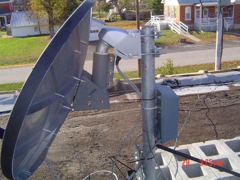

Hi Iceberg,
I have been using a cable tv plastic box that I get from a local tv supplier.
I currently have 2 - 3x4 multiswitches and a 4 way diseqc in that box with room for another switch. I just mount it to the mast, and wire tie the swtches to each other.
Edit: It only costs $5.00
See picture below.
Fred
The top has fits over the base with two little edges that fit into the upper part of the base, and it flips down and has a hook for a padlock, but I just stuck a wire through and gave it a twist.
Works great!
