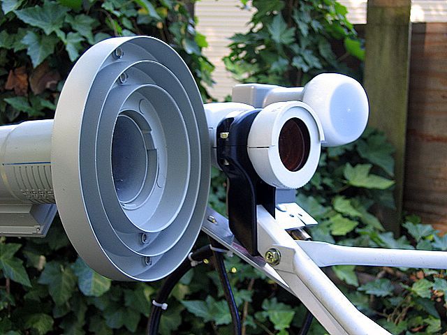

newguy, try the Cband LNB as close to the Ku LNB as you can get it.
I had a superb sig strength off Anik with an Invacom and DBS LNB on the feedarm, the Cband LNB isn't too picky where it's situated on dishes this small.

Cascade, would you mind posting some more pics of your lnbs showing the hardware setup. I am going to work on a similar project later and am looking for as many ideas as possible. Thanks.
