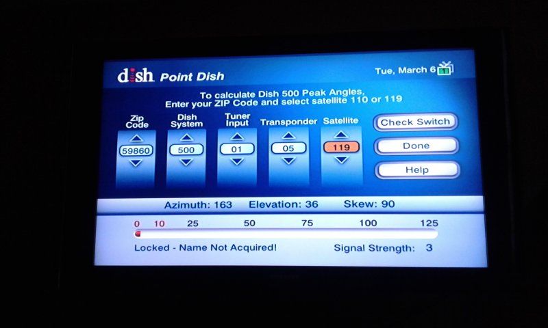

I have since tested the switch on all the TV's and boxes and now it seems to be working right Here is a pic of the screen i took this AM

You may still have problems a signal strength of 3 is unacceptable. signal bar is red and not locked
Did you scroll through the transponders on 119 to see if TP5 is a spot beam pointed somewhere else (just throwing something on the wall)?
I have since done the test switch test on all the TV's and boxes and It seems to be the solution. Before it would say "weak signal on HD channel switching to sd and then say complete signal loss screen
Has not done that since i did the test 6 hours so maybe i am good
Reactions: TheKrell

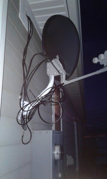

As I was wandering troubleshooting the problem I saw this and it irritated me. This is what the dish guy left. Now I admit I am not the most finicky guy but this is poor work. And reflects badly on dish satellite repair guys.

That would make me want to beat someone's face in. I've taken pics like this and sent them right to the tech with a not so nice message attached

That looks like sh*t.
It only takes a few minutes to make the wiring look nice

Well I didnt get the name of this tech? All i know is he was from Lolo MT and was busy in Idaho the past month and Seemed to be hmm non enthusiastic about working. We had dish network support call the tech and i guess that is rather random at times But since i worked in the business < fire burglar alarm and communications I made it right but It shows that experts are not always someone to trust
You were there, right? Why did you sign off on that if you are in a similar trade? You should have insisted he tidy things up?
