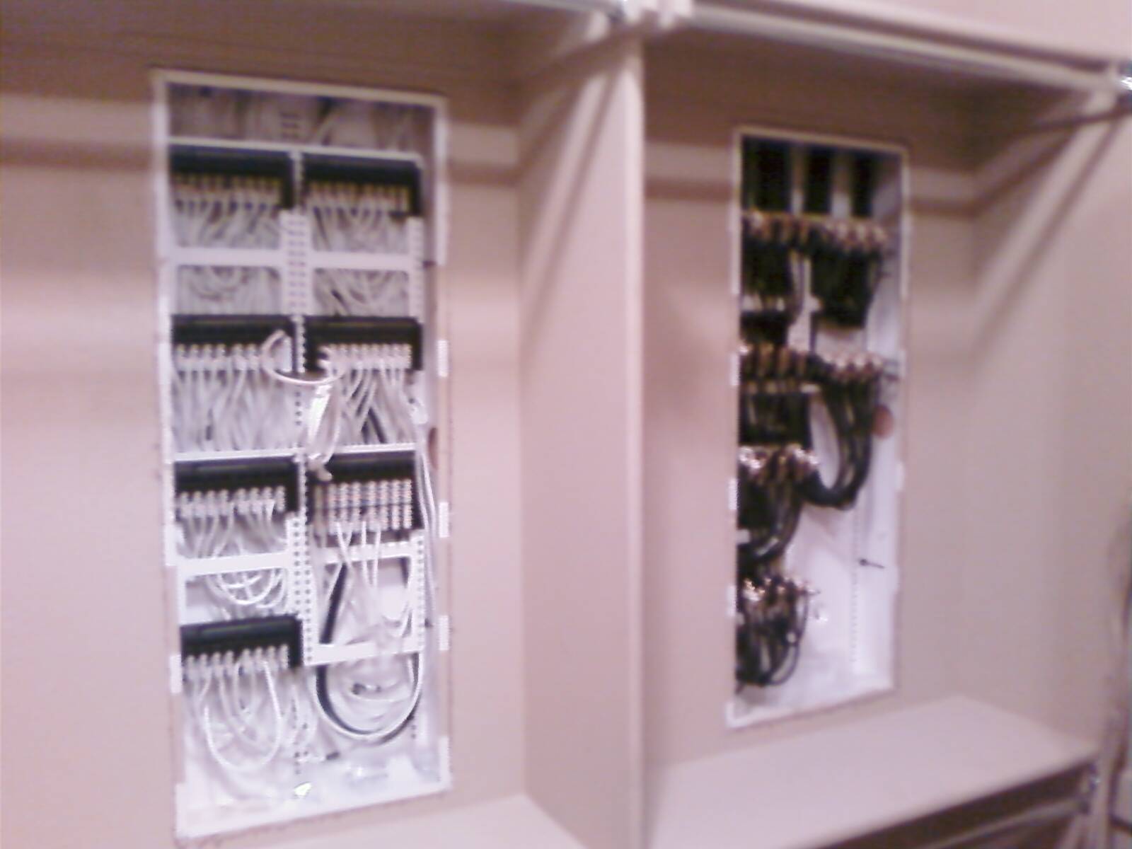

Based on what I've read, I'll be using 1 Hopper and 3 Joeys. The home builder tells me that there will be one cable connection available on the exterior. This one cable will lead to an interior distribution box. The interior distribution box will provide a grounding point and access to 4 cables. Each cable will be routed to a wall plate in a room.
In your reply to the question "What wires/cables/? will run from the dish to the distribution panel?", you said "A minimum of 2 rg6 cables with attached grounding messenger is required." and "Each Hopper will require it own cable from the dish to Hopper. (No splitters)"
So, I'm confused. How many cables are needed between the dish and the Hopper, two or one?
Assuming its two, then I'll need two cable connections available on the exterior of the house, and these two cables will need to run all the way to the room where the Hopper will be, correct? And then, do cables need to run from the Hopper to each Joey? Or, is the connection between the Hopper and 3 Joeys somehow accomplished at the distribution box?
I'm thinking that perhaps my interior distribution box and interior cabling is set up to work with cable, but not satellite
Thoughts?
Thank you
Minimum 2 wires coming in from outside. 1 hopper can get by with 1 cable inside and the rest of the connections can be made in the distribution.
HOWEVER, if you plan on having cable internet, what cable will that use if you only have 1 cable coming in and the satellite is already on that line. If it's new construction now is the time to add additional cables. Personally I would have at least 3 - 3GHZ RG 6 coax coming in and 2 cat6 ethernet coming in to a central distribution point. I would have at minimum 1 RG6 coax and 1 cat 6 ethernet going from the distribution box to each room.
When I built my house I did all the wiring myself and I have 6 RG6 coax coming into my distribution box from outside and 3 cat6 ethernet. Each room depending on use has at least 2 Rg6 and 2 ethernet and some have more in addition to speaker wiring in 3 rooms. Cable internet, alarm, phone, satellite, antenna, security cameras, they all add up and it is easier to run cables before insulation and sheet-rock go up. You never know when a cable might go back or get nicked so having extra is nice too. These are my distribution boxes
There are a alot of posts here, of people who used both and will say the Hopper is better, and many who will say the VIP series was faster and overall better than the comparable Direct TV line. Then again, you can find posts the other way. Seems to me what osu1991 posted is more near the truth.
You really want at least 3 lines coming from the Dish installation area to your distribution area. That will give you room for expansion, like maybe 2 hoppers or one hopper and a Super Joey...
