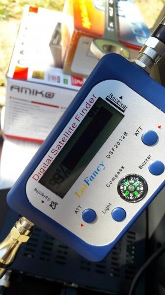

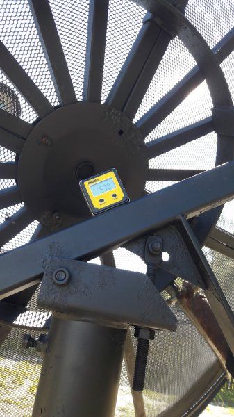

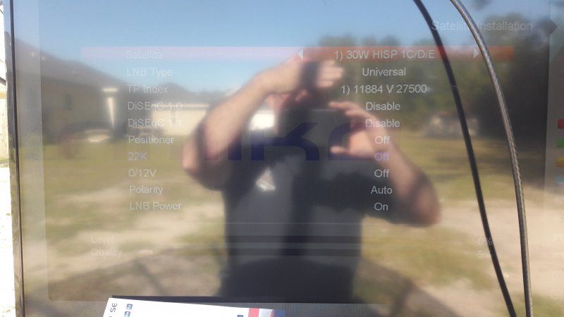

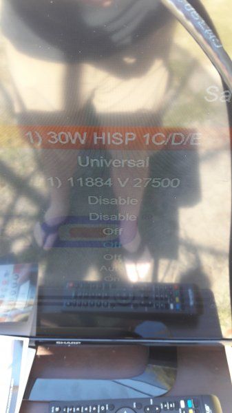

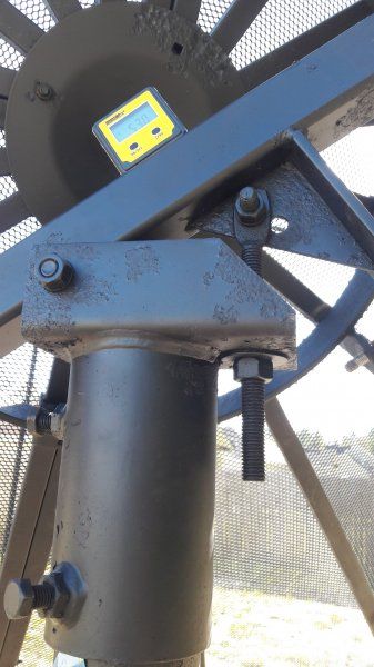

Hey all....I finally have the LNB installed on my 10ft mesh Channel Master today...couple of questions...first dish pointer online has the info for my Lat. and Long. which I have entered into my Amiko Mini HD...then it has the degrees for elevation for the dish...at 52.1 for the VENESAT-1 , in the pics my dish elevation is 53.0, I need to adjust the long elevation bolt you see there correct???.Next my sat finder tells me I am receiving signal at 99% at the moment but not sure which bird I am on...but on the screen it seems I am not getting good quality or signal strength...I feel I am not too far off from tuning this dish in...help would be greatly appreciated.. sat tuning pics 003.jpg sat tuning pics 006.jpg sat tuning pics 007.jpg sat tuning pics 005.jpg sat tuning pics 004.jpg

FYI: The meter will show a reading when you are receiving any type of signal. A properly configured recevier will show you when you are on the correct satellite.
Install Menu settings are not correct.
  • Select a C-band satellite from the list that you are attempting to find. Easiest if it is near the top of the arc.
  • Set the LNB type to Standard with a LO frequency of 5150.
  • Look at a satellite list chart (www.sathint.com) and identify a C-band transponder that is active with compatible DVBS or DVBS2 programming.

When the dish is parked at the top of the arc, it should be pointed to true south (magnetic compass reading 187.1°).
I would recommend using a modified declination table. Check out this post by FatAir: How I set the Declination on my antenna
At the top of the arc, the face of your dish will be aimed at 52.2° when the declination is set to approx. 4.7° and the elevation set to approx. 47.5° (52.2 - 4.7)
Bump the dish East to 78w (compass reading: 181.6°) the face of the dish should drop approx. 1° to approximately 52.1°. Place the satellite receiver on 78w C-band and select or manually enter TP: 4048 / Horizontal / 1299. While watching the Signal Quality meter reading. May need to bump the dish East or West to locate and/or peak. If found and Signal Quality reading is peaked, do a transponder or Blind Scan.
