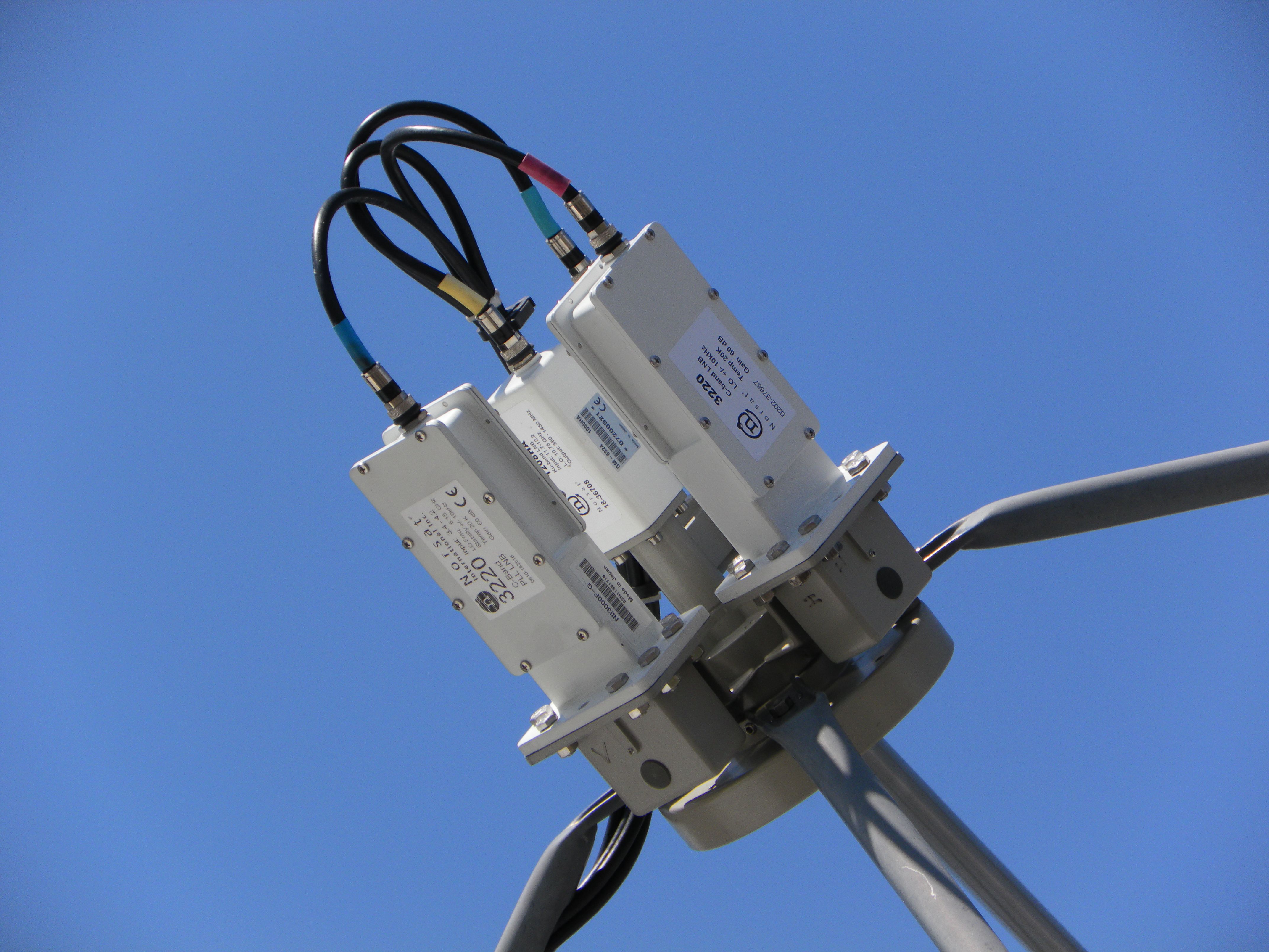

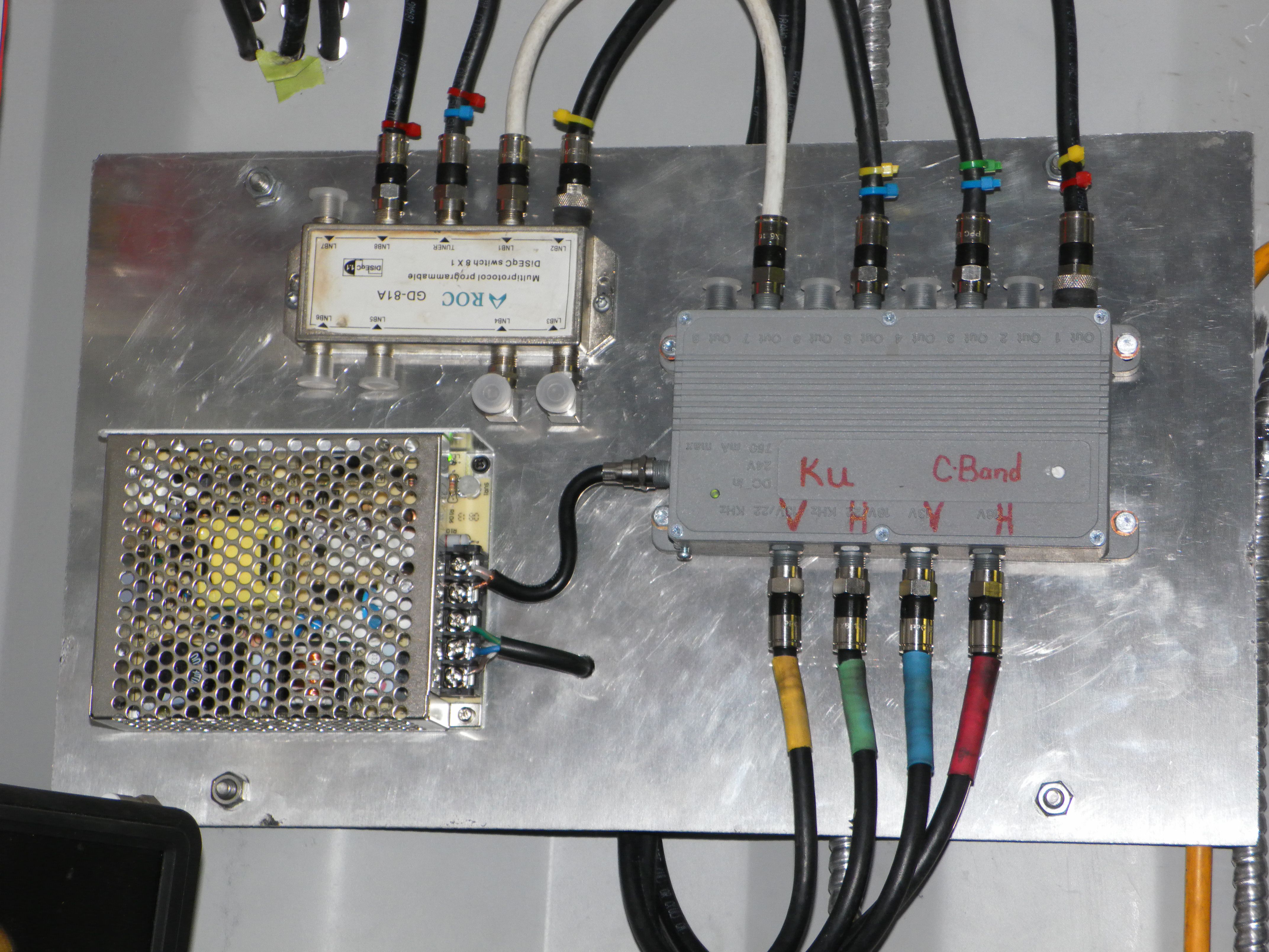

Soo....if trying to put together a dual C/ku system can this be done with pll digital lnbs on a dual feed horn without a corotor so everything can be controlled by the digitally switching, or is there some other way to go about it?
(And just for giggles, we now live in a place with tremendous magnetic interference, so every compass reading is at least a20 deg off from the last and even GPS locating equipment gous wonky here ...the yard is going to look like a spiderweb of coloured strings time we finish to get a proper location on things :-)
Thanks
Yes, this is what I do. I have a Bullseye II feedhorn and 4 PLL LNBs. Switching is accomplished with a powered multi-switch.
