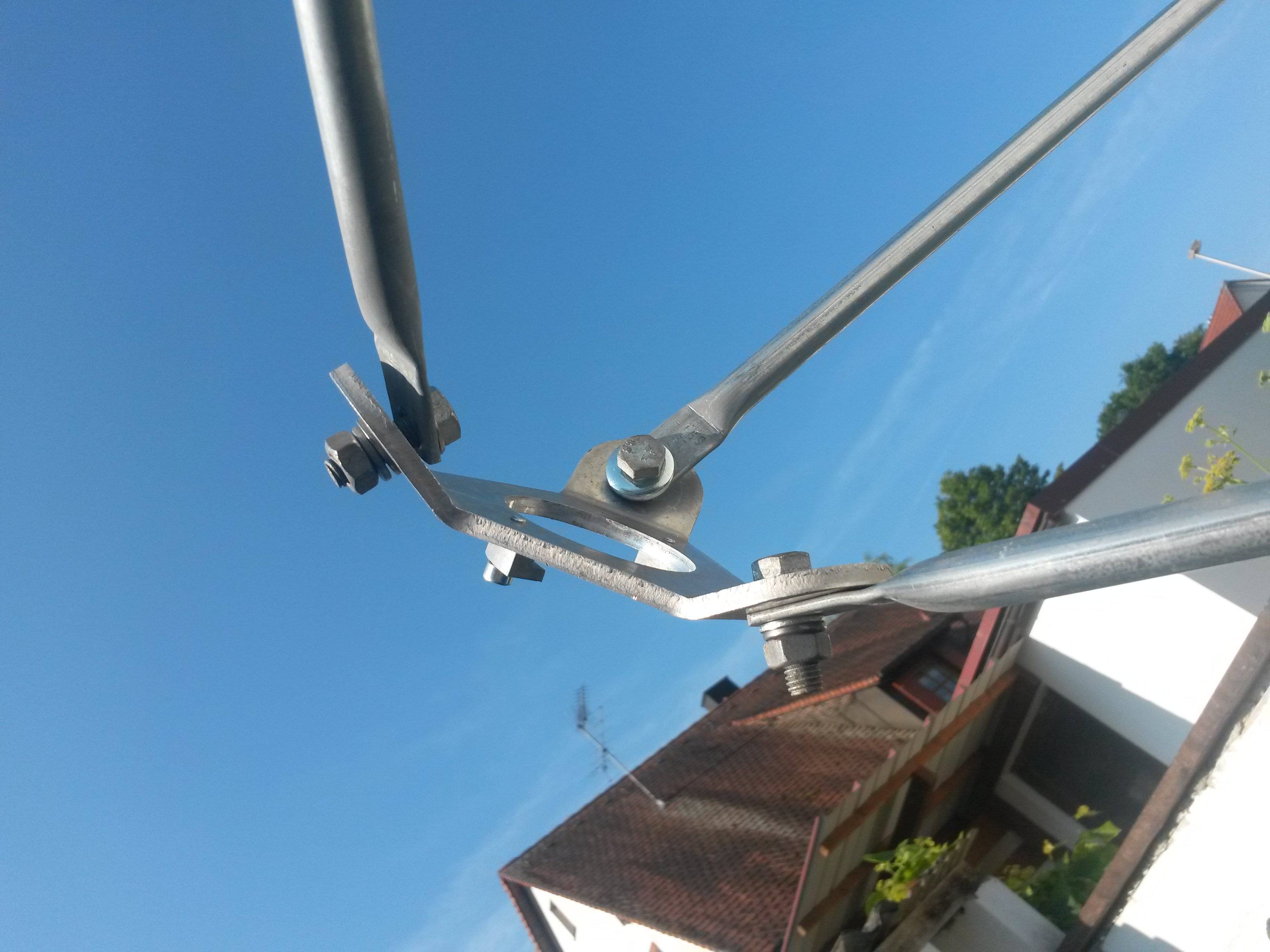

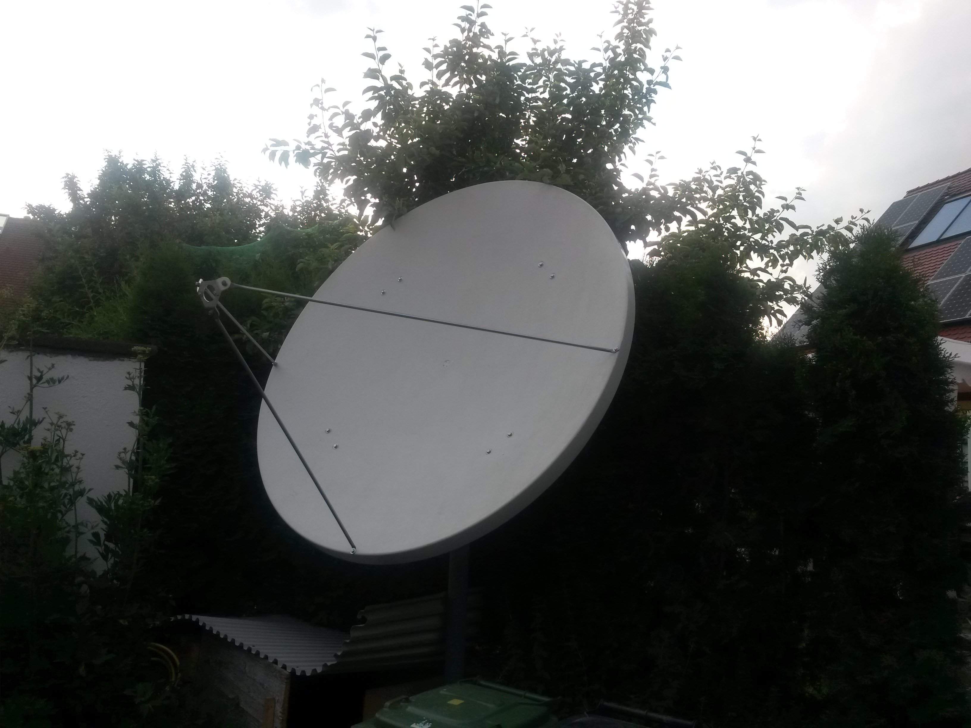

Hi all, my name is Alex, I'm from Germany and I am trying to rebuild a Prodelin (badged as an Echostar) 1.8m dish as well. I have almost everything I need, except the feed bracket and clamp and the feed horn itself. The guy I got he dish from tells me I got everything he had for the dish but I seriously doubt that the provided feed horn and feed bracket is the right one for my dish since it simply doesn't fit. I already contacted the guy who sold the one on ebay (mentioned earlier in this thread) but haven't received an answer, yet. I attached a picture of the I have but as I said I am very certain that this is not the right one. If you have any hints and tips for me where to get one of the right bracket and clamp I would be very grateful.

Well, thank you! I had a feeling that this was the case.
You wouldn't know a place (online?) where I could order a right holder, would you?
I think it is still possible to use one you have. If you only can manage to align LNB as it should be, I mean in focus and pointing to the proper direction.
But I also only have a PFA feedhorn and I am not sure, if I won't cost me a lot of signal strength
I did mean if you fix LNB in that holder and by adjusting all 3 fixing bolts and nuts, manage to place LNB in focus, than signal strength will be exactly same as you where using original LNB holder.
Would not recommend using the current flat scalar as the reflector will be over-illuminated and have poor performance. The measurements and suggestions provided earlier in this thread should allow you to correctly position a 65mm clamp to secure the C-band feedhorn. Once the feedhorn is correctly positioned and aimed into the reflector, add a conical scalar to properly illuminate the offset reflector.

It is a bit pricy and I a also a little confused because Chris from Sateng just answered my e-mail-request and gave me a price of $135 for the exact same item which they have listed for $107 on their website... I also contacted General Dynamics here in Germany today but haven't gotten an answer, yet. I'd rather go for the original setup, since I will use the whole 1.8m for an out of footprint reception of the British TV stations. So I would like to be able to use the full gain of the dish.
2superal55: Do not be in hurry to spend your money! Just put Inverto Black Ultra (10 EUR) in the existing holder, try to alight it properly and catch 28,2*E. If it does not work than maybe consider to go for buying some original parts.

Yes, I will of course play around a little with what I have. Otherwise there would be no fun, right? I might also be able to get the original part from the guy I got the dish from. He will check and see if he still has it tomorrow (but I doubt it). I live about 15 min. north of Erlangen (halfway between Nuremberg and Bamberg) in Bavaria.
