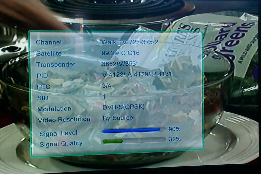

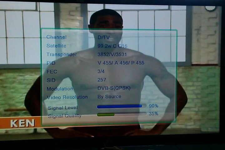

I tried a cband lnb on my 90 cm dish yesterday and picked up two channels on 99w . No luck on a few other satellite I scanned. This was just bolting a shortened bracket for the lnb on to the ky dish and hoping for the best. The focal point is still .75" higher than the ku lnbf was.

Well I tried agaian last night and got some channels on 55.5,91.0, 93.0, 95.0 , 99.0, 111.1, and125.0.
Some pics to follow.
