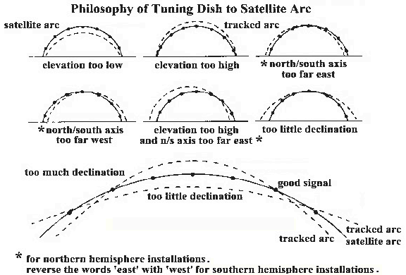

This may help...
I would make only small adjustments and be sure to mark your starting place so you have a reference point.
when you stop on the satellites you can get go out and push / pull on each side & top/bottom and see what affect it has ....this will let you know which way it is off. and then you can adjust it with the chart above

Thanks for the comments, Corrado, Lak7, Sergi, and Gabshere. Corrado the pulse count changed only after the severe windstorm, which unbelievably also knocked out the Declination from 6.6 up to 7.2 degrees, but I got the reception quality back on 97.0W after resetting Declination again back to 6.6 degrees yesterday, ...hope I don't have to do that again since it lasted 3 months previously. Also nothing is evident re loose hardware I'll check again. Corrado the Dish is on a Tripod and I can adjust it - it reads 99.8 on the Digital Level on the Pole and 99.9 in 4 directions on the Pole Cap of the Dish, and I can easily adjust it up to 99.0. But with only 1 welded Nut & bolt, and 1 screw without a welded Nut on the other side (instead of the required 2 Screws on each side on the Pole Cap) I wonder if this could this cause a Clark Belt tracking problem?
Gabshere, I have tried that procedure of Raising and Lowering the dish at various points, which worked well on my 1 meter Dish, - but it just doesn't seem to do anything on the 12 Footer, maybe the Dish is just too big?? Sergei, I definately agree that small adjustments are the way to go, but I'm just not sure what to try next!!

Thanks Lak7, I'll readjust Plum to 99.0 in all 4 directions and see if it helps. Also I did quickly notice after adjusting the Dish that bumping with the V Box III Left / Right a bit helps, and as you mentioned that is a great feature on the V Box III that I previously never had when I had to use the 12VDC Battery Charger.
