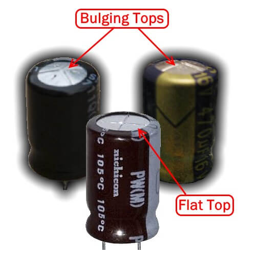

The capacitors in the power supply are going bad. If you popped the cover, you'd probably see several that are bulging.
