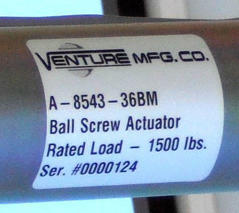

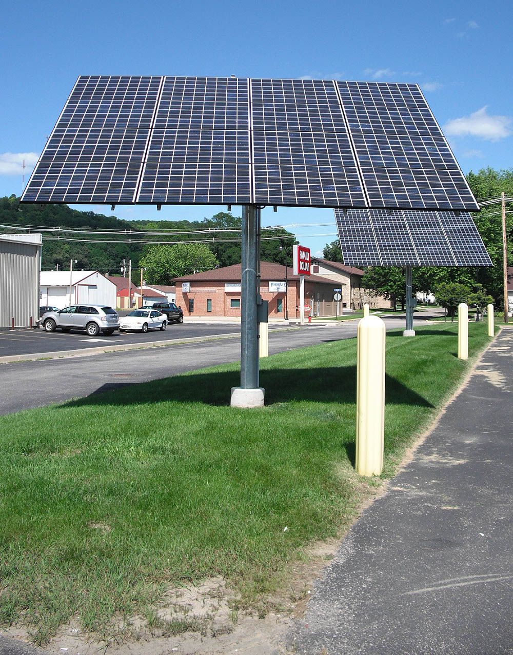

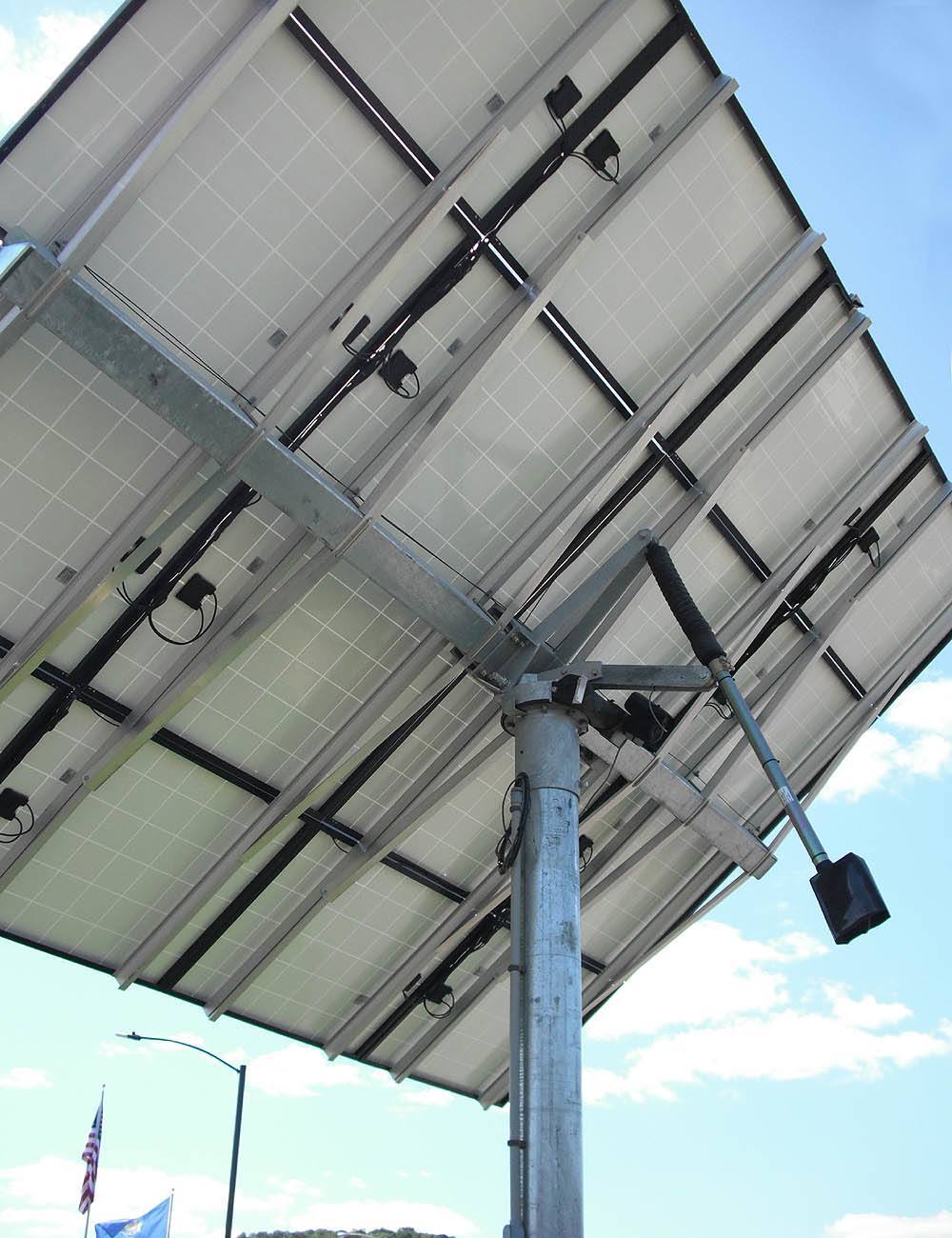

For what it's worth, here's the actuator used by our city.
The actuator will be the most important piece of your project. Don't get cheap!! Look for a quality built unit. The solar tracker will put more use in an actuator than a satellite dish ever does. You will spend $200 or more for a good one. Look at Von Weiss, Venture, Thompson Saginaw brands. This will give you more info to base a decision on.
And ***WELCOME TO THE FORUM****
So, I note that the Venture ball Screw unit says "40 pulse". Is that referring to a hall sensor output? Can someone link me to some diagrams or technical info on this?
Perhaps I don't need to worry about that at all? The electronics driving the whole mess will get feedback from the sun, not from the motor. Can I just drive this thing with 36VDC, without worrying about these pulses?
Most likely you won't use the pulses. They are used to precisely aim at a particular point in the sky. The solar trackers just use the sun position. You could, I suppose, design and build a circuit to use the motor voltage in combination with the pulses to have a digital readout of the trackers position. Or a failure detector of some sort that would go off if there are no pulses while the sun moves across the sky. I built the Red Rock simple LED solar tracker circuit and had it drive my BUD across the sky, worked great. Never did make a solar collector though.
