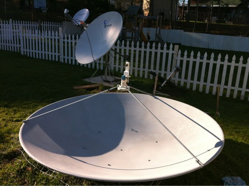

Made a score today and picked up an 8.5ft solid dish. Anyone know what brand it is? These were made well right? And able to pick up good signal for digital dvb/dvbs2? Should go well with my 6ft dish.

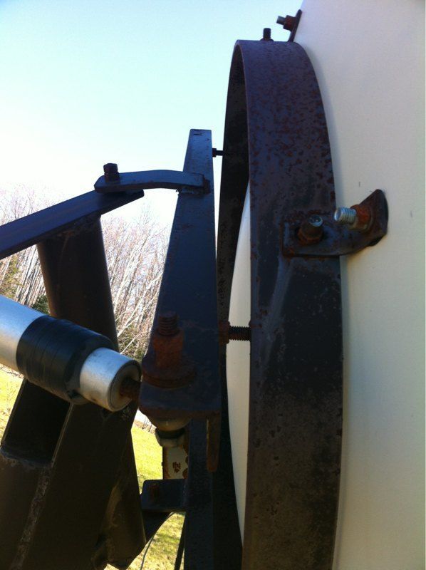

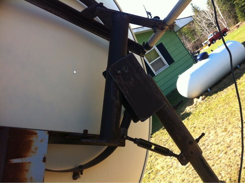

More pics of the polar mount. Looks like the declination adjustment is on the top.

Cool! I get a lot of S2 with my 8 1/2 foot Birdview. I don't know that brand but it looks good, Just do the string test to see if it's kept its shape. Maybe sand it lightly and repaint it with flat (not gloss) white.
On my first big dish, I had to run a wire edge to edge and pulled in order to bring it back into shape. Worked well after that.
Huzzah!
Always cool to find a nice dish. Yeah check it doing a string test, so no headaches in the future, and fire it up.
Ok ill make sure. Is a aolid steel or aliminum dish. Wow didnt think those would deform but ill check for sure. Seems like it would be rust by now if it were steel right? Cant wait to get it going.
Yeah probably Aluminum. I have seen metal and fiberglass out of round for various reasons. Just never hurts to check, before you start pulling out your hair.;)

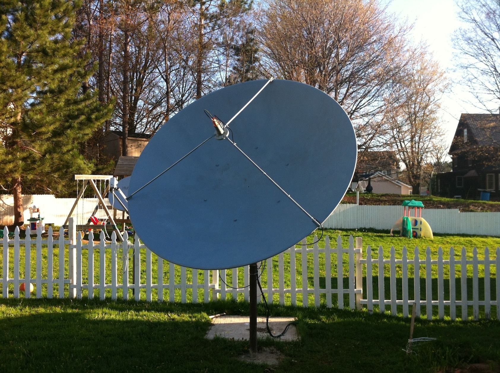

Here is the dish at my place. Painted it gray. Came out pretty well compared to my original pics. Notice my 6ft dish and hughsnet converted fta dish with a qph-031 in the back. Have the hole for the new dish right in front of it since thats the only place to see the full arc to 139w from 60w

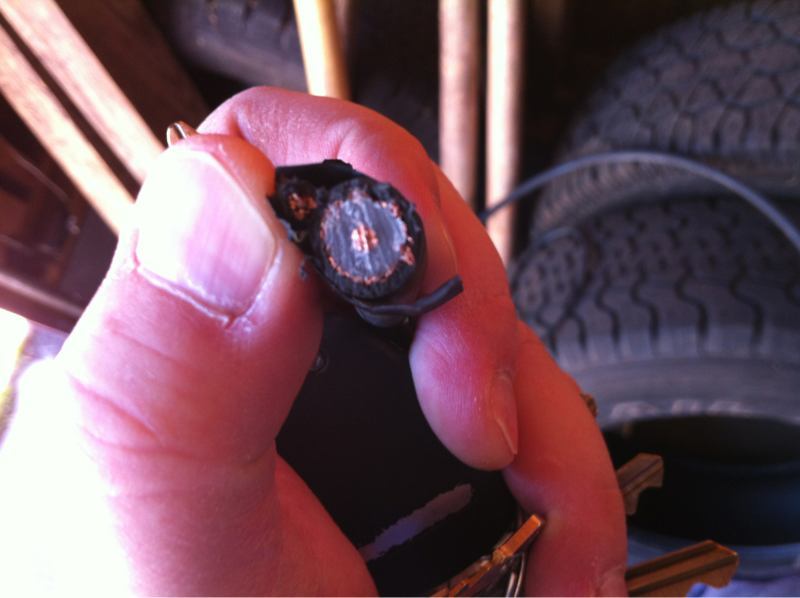

Also look at the co-ax that was from the chaparell feedhorn to the service box. Its super thick 6core coax or somehin. Never seen it before. Regular rg6 from the service box to the house.

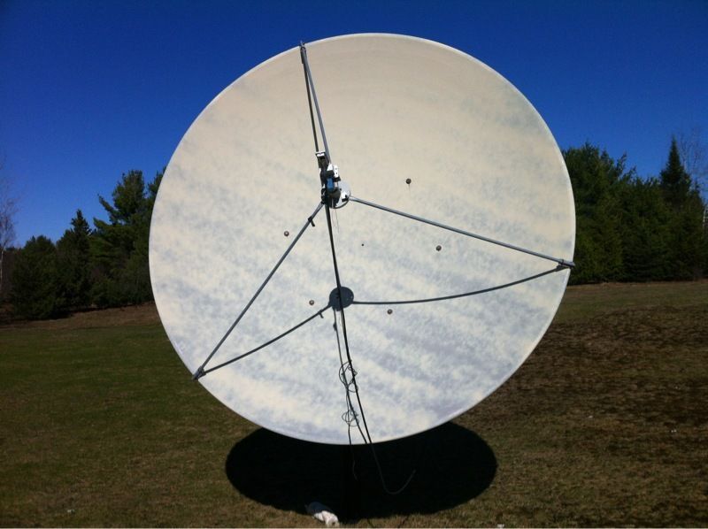

Well Here is the dish folks. Finally got it installed and tweaked. Its 8' 8" so almost 9ft solid aluminum. Pulling in everything strong. NBC's on AMC18, ABCs on 99w etc.. 84qual there. Works great. WAAY better than the 6ft it replaced. Definitely worth the work. Hooked to my openbox->gbox mover with dsr-4200 and a toshiba DCII box slaved off it. QARL PowerTech 24" actuator.
I don't think I have ever seen one just like that around here.
Nice find and install, enjoy.
