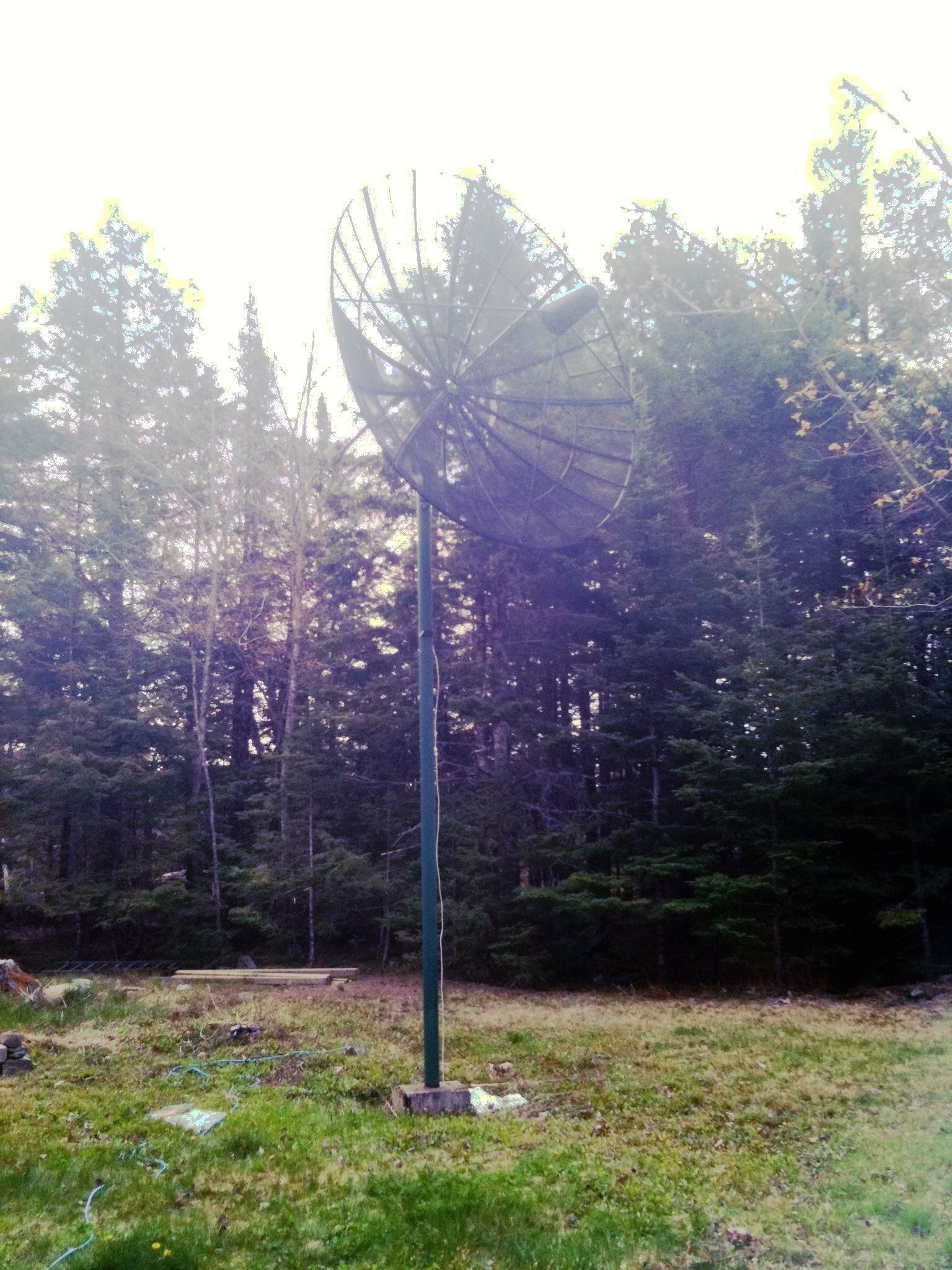

View attachment 50813I got the BUD down intact. What we did was go up a ladder and tied a rope around the mount on the back side of the dish. Next, I used a grinder and cut half way around the pole. Then a buddy started pulling on the rope while I continued to cut. When it started to go I stopped cutting and let it come down to the ground like a tree. Worked great with no damage to the dish at all.

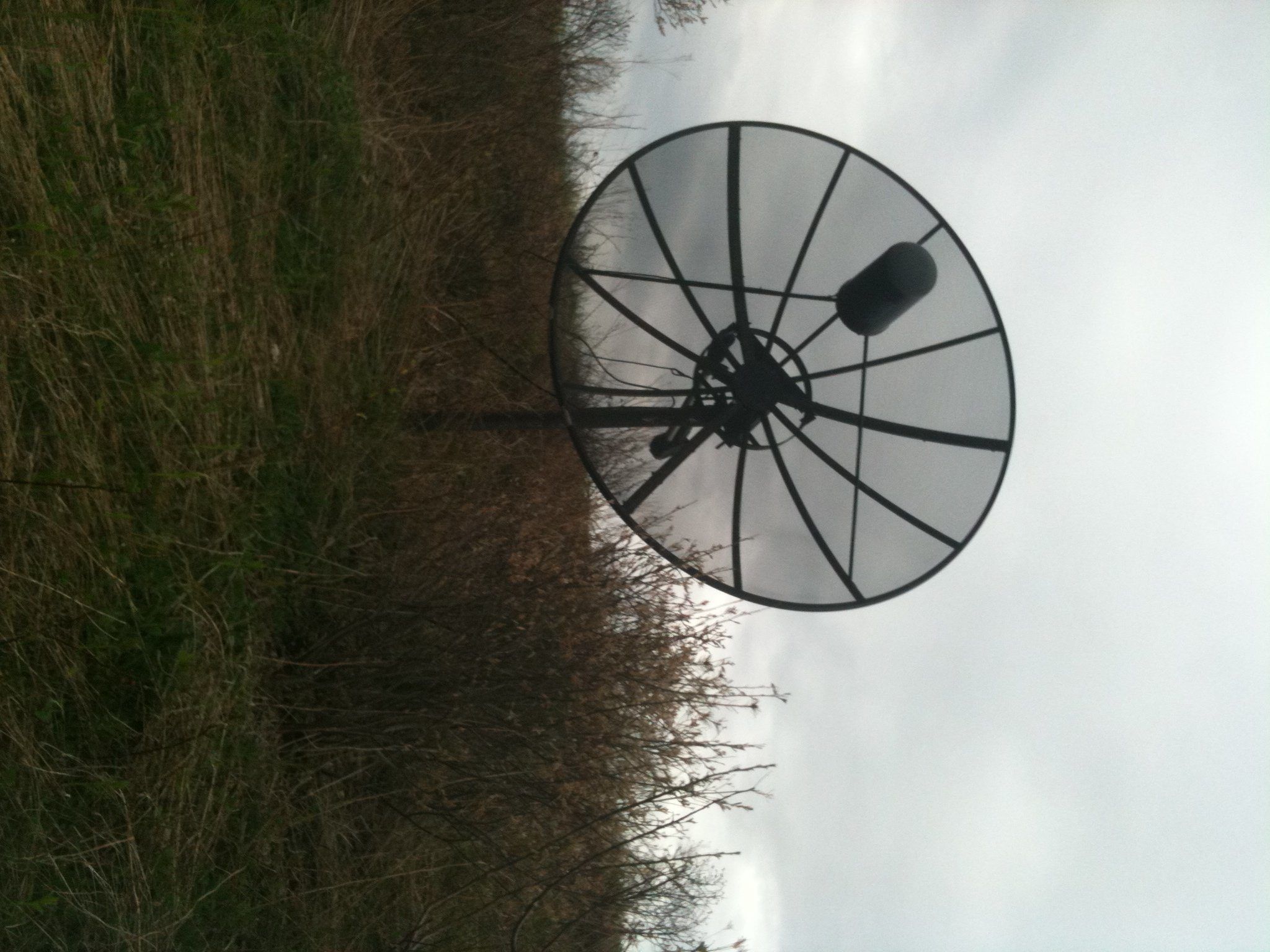

Here's a picture of it. I don't know who makes it. I saw a partial label on it that said Canadian Western something. Has a GI orthomode LNB and corotor. The LNB nor the actuator have been hooked up in a long time. Only broke six bolts. :)
Here's the new baby before it came down:
