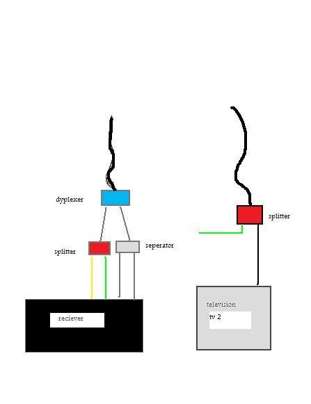

If possible, extend the uhf antenna to the tv2 location. you will need 2 splitters and a few jumpers. At the receiver, hook the 1st splitter up like the seperator is hooked up, Tv2, and UHF antenna both going into the outputs of the splitter, and the input of the splitter goes to the diplexer. At the tv2 location, take the cable from the tv to the input of the splitter, on the outputs of the splitter put the antenna on one side and a jumper to the tv on the other side of the splitter. Hope you understand the way I worded it and hope it helps.

Do you have a diagram for this hook up. I have raised my antenna above the entertainment center, but TV2 remote (6.3) still only works when it feels like it. So I want to move antenna to the same room as TV2. Thanks. Peter.

Yeah you need the "Pig tail" splitter trick...
Here is a diagram I made up a while back.. You need two splitters to do this - also the spots where it says diplexors you can skip those if you don't have it and you've just got a line going out the back of the box to TV2 straight shot.
i got on my laptop and made a diagram using paint.. maybe it'll help explain, as a supliment to the reply that beat me to the punch..

If you bothered to click on the "extend range" tab, like I stated, you'd have seen several diagrams of the so called splitter trick. :rolleyes:
However, the above diagrams are just fine.
I appologize. I didnt read your whole post just saw the link and then a diagram to the remote.
