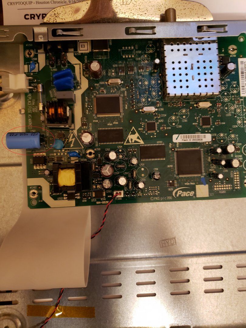

My AM21N started giving me the Local Channel Connector (LCC) Not Detected error. After fruitless attempts to get Directv to send me an LCC kit, I decided to crack the AM21N open and have a look. I noticed that the large capacitor C2507 had a little bit of crustiness on the base around the positive lead. It was a 22 mF 400V cap. I couldn't find that exact spec locally but I did get a 22 mF 315V cap. Desoldered the old one, soldered the new one in and BOOM - it works again! Anyway, I thought this might be helpful for anyone who has an AM21N that exhibits the same behavior. I attached a picture with the location of the offending cap circled.

Yep. This is the second one I have repaired with caps. The first one was an older AM21 that had a couple of bulging caps. Fixed that one back in 2017 and it is still working.
The AM21N I just did was about 5" x 7". I don't remember the size on the AM21 I did 3 years ago but maybe it was a little larger.
It definitely had some different caps around the tuner section enclosure.
