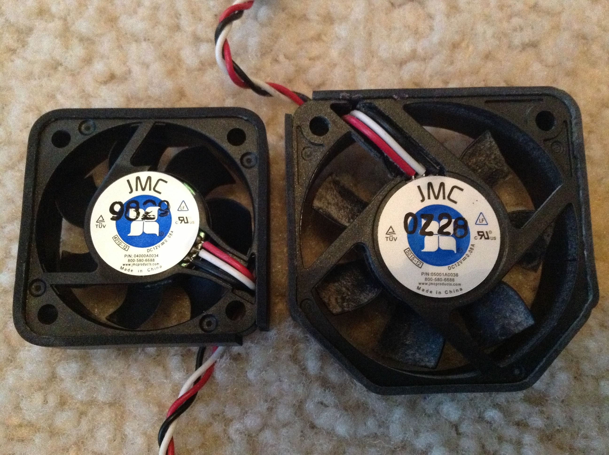

My fan is broken!!!! My HR24-100 has a fan with beveled corners on the bottom two corners. Most fans I find on the web are all square. There is a guy on ebay selling a HR24 fan and he warns there are two types for the HR24-100. The pic he has on his listing does not match mine. The fan he is selling has regular squared corners. I guess I could cut the plastic angles in the fan holder area to allow the square fan? Finding this fan has not been easy for me. Any leads???
HR24 eBay Fan
Wrong fan - EBay
JMC Part No: 04000A0034
Right fan
JMC Part No: 05001A0038
I ordered the HR24 fan from eBay seller "justpal." It arrived yesterday.
It is smaller and doesn't have the beveled corners. It's too small to firmly fit into the fan cradle and basically sits there loosely. If the HR24 were moved, then it would fall over, unless it was glued or double sided taped down.
If you could get it glued or taped down, it's size causes me to wonder about its CFM ability.

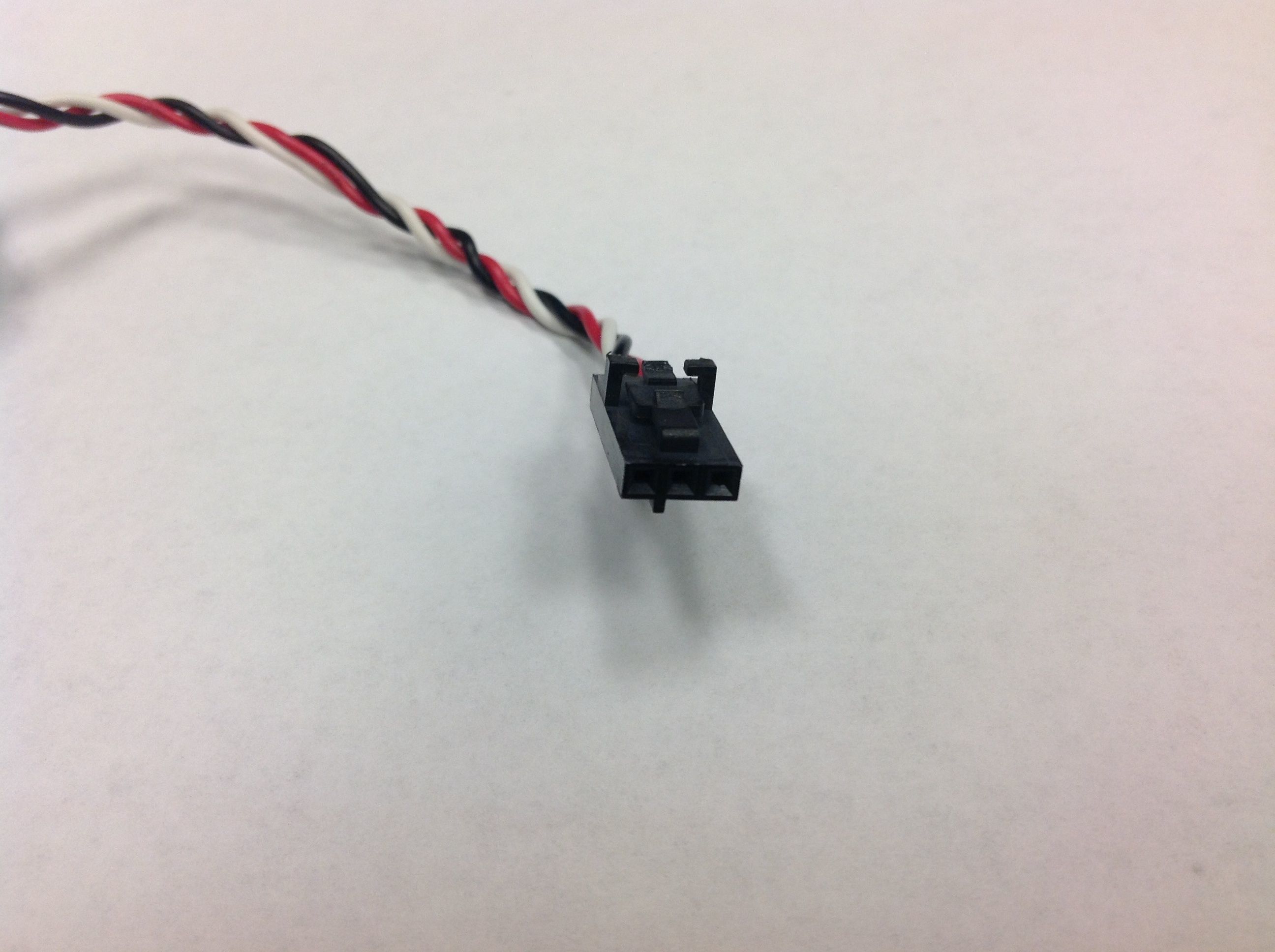

The three conductor plug on the wire does snap into the receptacle.
Wrong fan - EBay seller "justpal". JMC Part No: 04000A0034, Model No: 4010-12.
Correct fan - JMC Part No: 05001A0038, Model # 5015-12.
Breakdown of model numbers
Correct fan
5015-12
50 (50mm H x 50mm W), 15 (15mm D), -12 (12 volt DC Voltage).
eBay Fan
4010-12
40 (40mm H x 40mm W), 10 (10mm D), -12 (12 volt DC Voltage).
Both fans draw 0.08 amps.
I have uploaded a picture of the two fans, side by side.
The eBay fan, JMC Part No: 04000A0034, Model No: 4010-12, is on the left side of the picture.
The fan that I actually need, JMC Part No: 05001A0038, Model # 5015-12, is on the right side.
I also uploaded a straight on picture of the connector.
I suspect that JMC # 05001A0038 is a discontinued item and DirecTV probably changed out the fan to a newer fan that was readily available in the Supply Chain.
I am also exploring getting a 50mm x 50mm x 15 fan from an alternate source.
I noticed on Partstat.com, an Electronic Components Search Engine that a Global Supply Chain Company, Celestica Inc, is sitting on a Qty of 5007 of these fans. I suspect that they will sell these in volume only.
I took the chance and called their Austin Sales Office and left a message with a callback number. Maybe I will ask for a sample if I can get through to the salesperson.
The seller did caution in his auction that there were two different fans for HR24. I thought that the differences were the beveled corners. The correct fan is larger.
