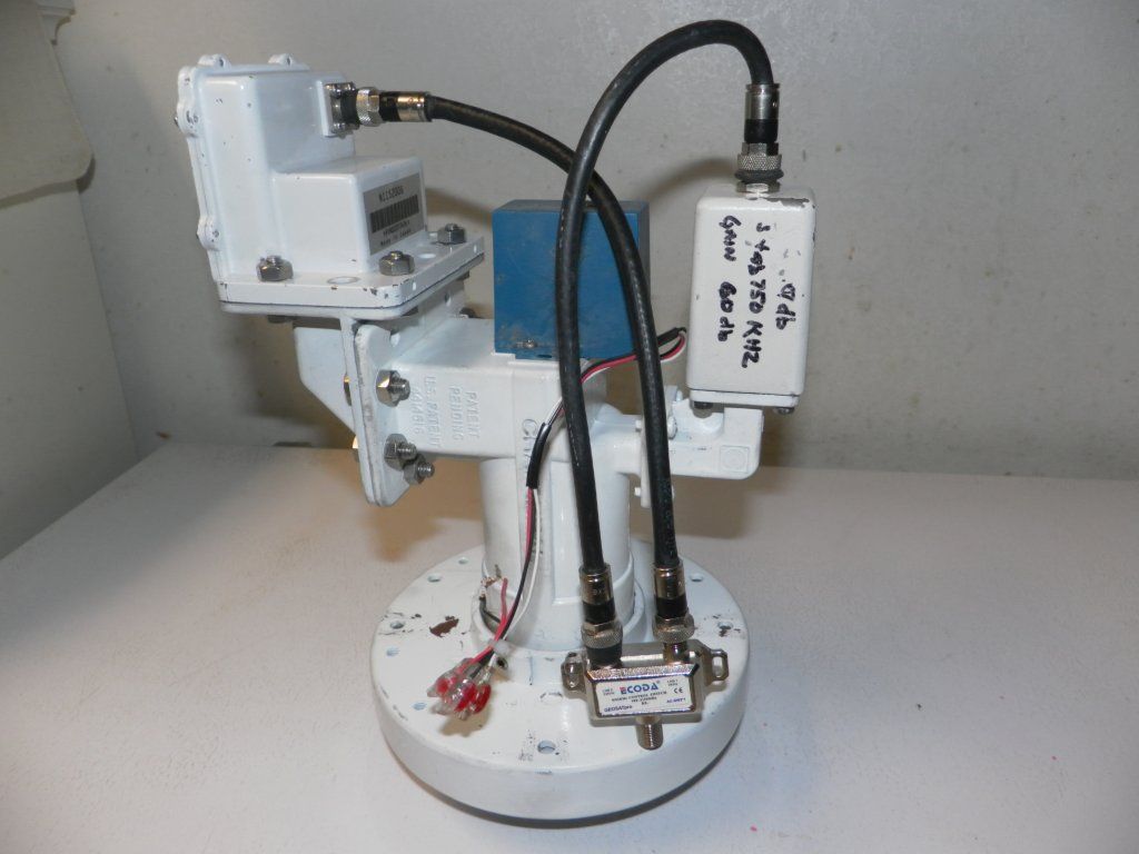

Not much in the way of C/Ku LNBFs out there but would be cheaper than a Corotor feed horn. But to combine the C and Ku most folks use a 22khz tone switch. Here is a picture of a Corotor and switch ready to install
