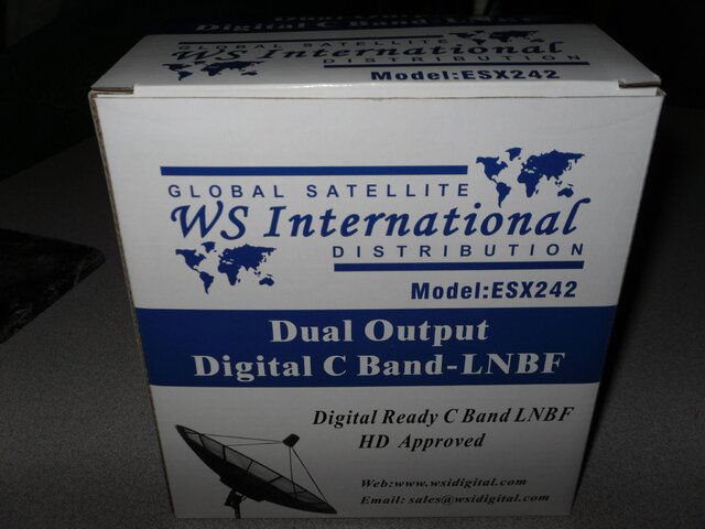

I had the opportunity to test this product this morning, I have been looking forward to testing it since it showed up on the Brown truck.
Opened the box, this is what was inside: the LNB, hardware kit, and scalar. Nicely done.
