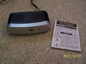

I have a setup where I want to send a signal from a DVR recorder from downstairs to my TV set upstairs.
I have used an RF modulator to do this with my other TVs, and it worked great. In fact, it still works great with my other TVs, but for some reason I cannot get sound to come through to my new LG LED TV when sending through the RF modulator via the A/V jacks. If I send a coax signal on through, I get sound no problem.
I talked to a guy in Best Buy about it, and he had no clue.
I tried scanning all channels to see if it was because manually defining channel 3 on the LG tv was causing the issue. It scanned in as both an analog 3, and a cable channel 3. However, still no sound when I try sending via the A/V jacks of the RF modulator.
Could it be my RF modulator is only sending mono sound? Do I need a newer RF modulator?
I will try attach a photo of the RF modulator I have.
Anyone have any ideas?

Forgot to mention, yes, I do get video, just no audio.
I am splitting the coax coming out of the modulator OUT, and the other TV receiving the signal has the video and audio.
Also, the same coax coming into the LG LED TV when the DVR is turned OFF is getting the signal from the coax (the output of my digital TV converter box), and then has video and sound just fine.

I tried hooking a DVD player straight into the RF modulator (instead of my DVR). Just get video, No sound.
I tried hooking the coax out straight into the TV (no splitter). Just get video, No sound.
I tried resetting the TV. No change.
I tried LG customer support. They told me since the TV gets sound for everything else, it must be the RF modulator device and I should contact the manufacturer. Ha, I bought this RF modulator like 15 years ago. I told her the RF modulator works on all my other TVs, it has to be the TV. She says TV gets sound for everything else, must be RF modulator. Round and round we went, without any resolution. I asked them to try an RF modulator on the TV in their shop and to let me know their results. Will see if I hear back from them.
I am convinced it is the TV. I have gone through and tried different sound options on the TV, no luck.
For now, I am going to use my HAVA device to pipe my DVR to the upstairs TV, since now I can hook my laptop to the TV upstairs directly with HDMI. It ties up my laptop when we want to watch something I have recorded, but will work for now. I also tried my portable hard drive with recordings from the HAVA, and they played fine on the new TV as well (so I could just transfer my DVR recordings to the portable hard drive and play them on the new TV, thus not having to slave the laptop).
I am tempted to have them try an RF modulator in a retail store on this TV to see if it is just me or the TV. Maybe LG will try it and get back to me.
