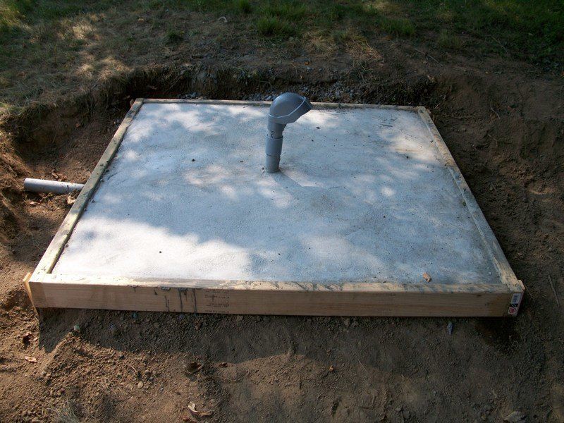

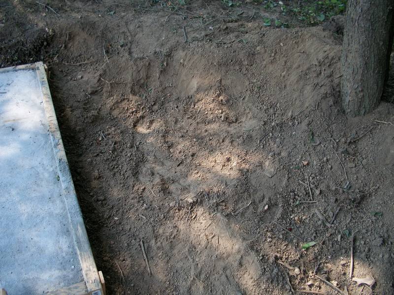

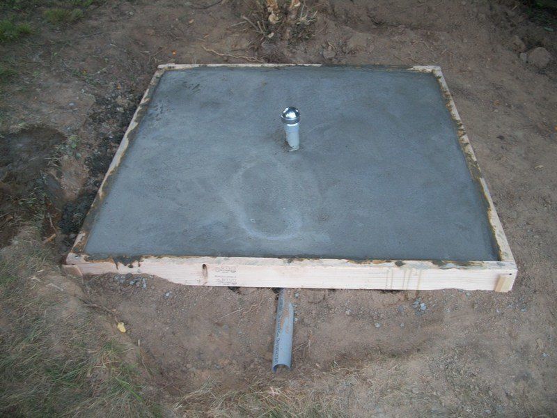

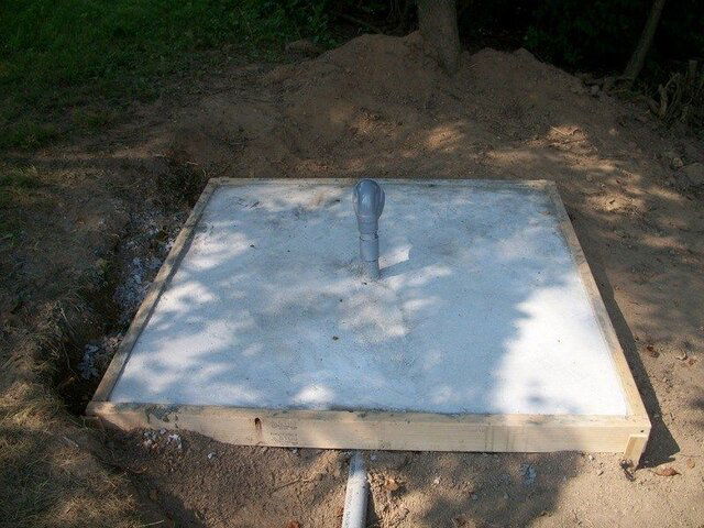

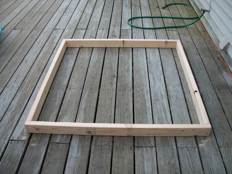

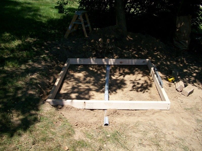

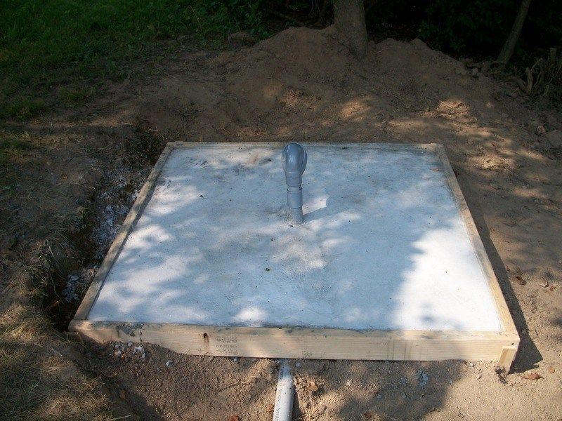

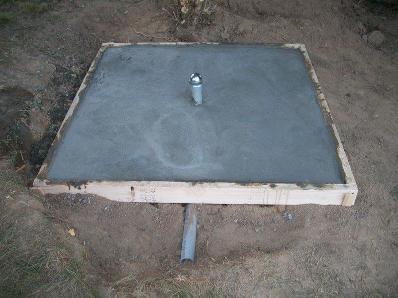

Today I cleared the area for the new 8' (240cm) stationary dish, leveled 4' x 4' wooden frame, added rebar, rebar chairs and conduit for coax and poured the concrete. As you can see in the last photo I should have worn older shoes. :) Concrete pad is 4' x 4' and 6" deep. Used 12 80lb bags of concrete mix.
Tomorrow while the cement cures I will begin assembling the dish and enjoying the Fourth of July holiday with my family.

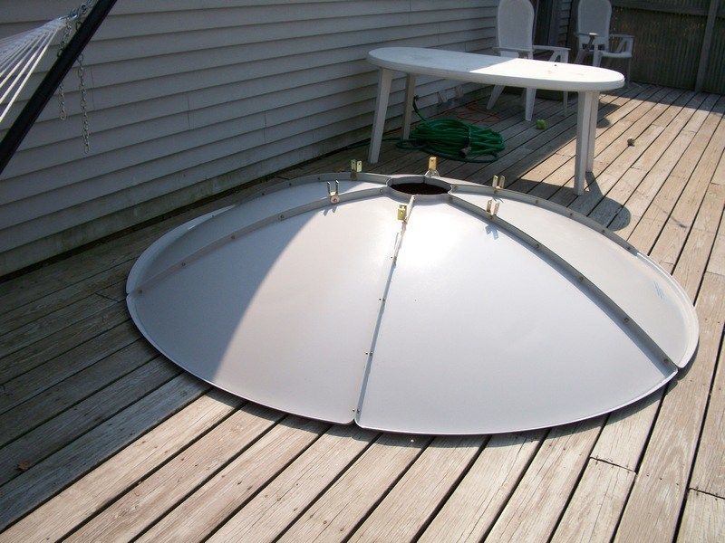

Update JUL 05 2010
Today I did the following:
1) Installed cap onto conduit.

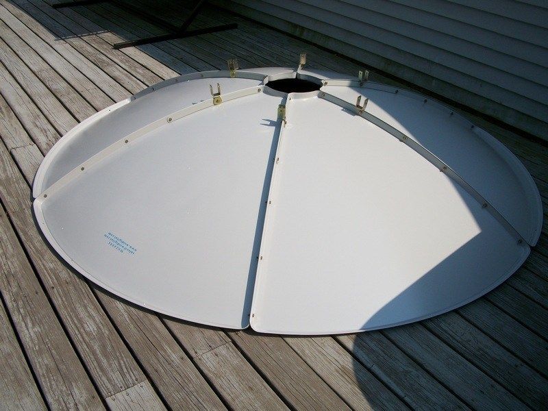

2) Assembled dish panels.

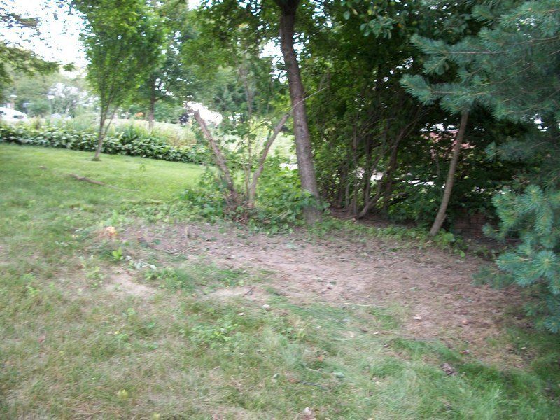

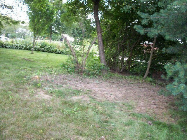

3) Removed shrub behind pad including roots.
4) Ordered 250' of direct burial RG-6 coax on EBay for only $27 including shipping.
