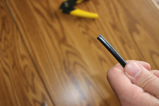

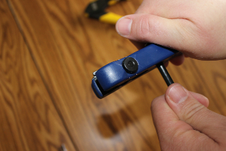

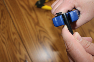

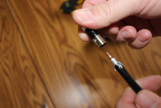

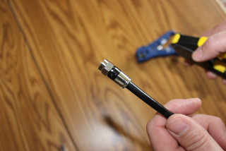

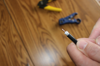

First use your stripper tool to cut the coax like this:

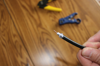

Then rotate the stripper tool on coax to remove the outer and inner sheaths to expose the copper conductor and braid:
Fold braid back over outer sheath:

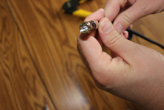

Place connector on coax so that center foam (around the copper conductor) is even with the inside edge of the connector:

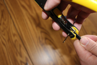

Insert connector/cable into compression tool and squeeze:
Done!
