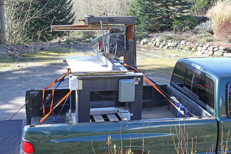

I had found an old Delta Radial Arm saw on Craigslist which had been sitting out in the weather for some time. The "bones" were good and the price was very right.
Kind of like some of our satellite dish deals.
I got them to load it in to the truck with a fork lift and I brought it home.
I did not have a fork lift to unload it and it needed to be disassembled to be restored anyway, so I took it apart and unloaded it out of the back of the truck.

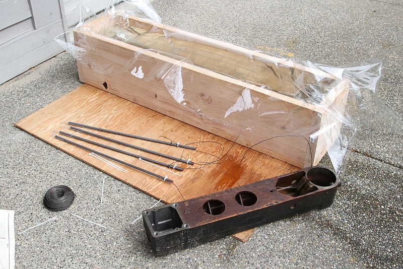

Some rebar
A container that's bigger than the rusty part
Some steel stove wire

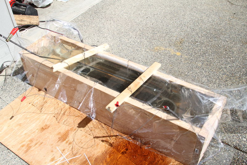

I built a container out of 2x12s and lined it with storm window plastic to make it water tight.
I have used a 5 gallon bucket for smaller projects and it's a lot easier, but it wouldn't fit this one.
Put the part in the water with the soap powder in the container.
Hook the charger PLUS SIDE TO THE REBAR, negative side to the rusty part.
It will start to bubble.
Leave it on until it stops bubbling.

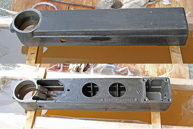

Here's a composite picture of the top and bottom of that part after a ride in the cooking tank for a few days.
Let it dry and get some good primer and paint on it and you are done.

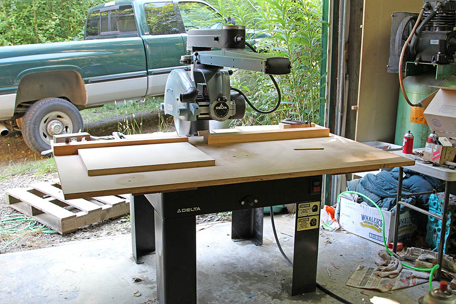

On the saw...
There was a metal label that I took off and found almost the original color of paint underneath.
I was able to take it to a NAPA store and they were able to mix up some paint that was darn near a perfect match.
Now you have to show us the finished saw when it gets done. :)
I did this project (by the dates on the pictures) in the spring of 2013, so it's been done for a while. It's down at the shop and it's kind of a dungeon but I'll try to get one that isn't as bad as the others. :)
The scariest part was the motor which is a dedicated 3 phase unit. I couldn't get it going at first so I took it down to a motor shop and they asked me what was wrong with it as it worked fine for them. My mistake. (Happily)
Oh and correction it's not a Delta it's a Rockwell.

To answer the question about the rebar....
I dangled a couple pieces parallel to the part (horizontal) just to get them closer. I also wrapped a couple pieces of vinyl tube around the part just to get it up so stuff could circulate around it. Don't know if you can see it in this pic.
