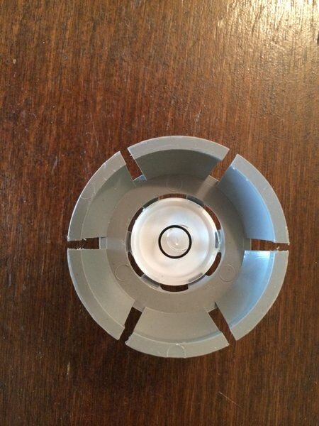

But, also a note on basics. Step number one is that you need to have the pole you are setting the dish on perfectly vertical. I strongly recommend getting a "post level" from Home Depot for around $5. This has magnets that hold it on the pole while you are doing the adjustments to the legs to get things vertical. It is so much better than other methods.
The other setup steps you seem to have down since you were able to do a good setup at home. So, the only thing I can figure is that you had a level spot at home and an non-level spot where you were trying to setup the dish and you didn't get your pole vertical.

You must have a deluxe model post level! :) The two I have are plastic and have tabs for rubber bands to hold onto a pole.

Those levels that fit in the top of the pole aren't particularly accurate. Better to use a post level.
Fair enough. I will be making a trip to a few of my local hardware / home improvement stores today! I can see where the bubble level could get out of position easily and I've often wondered about their accuracy. After taking a look at a few post levels online, I agree that it would be to my advantage to get something that was more "industrial strength". Appreciate the feedback.

Here is the post level that I use.

I now have my post level (used it to practice my set up of the tripod this afternoon) and it worked very well. Much easier to see if you're level or not. Thanks for that advice!

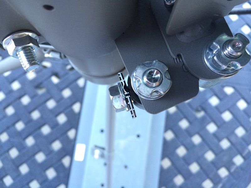

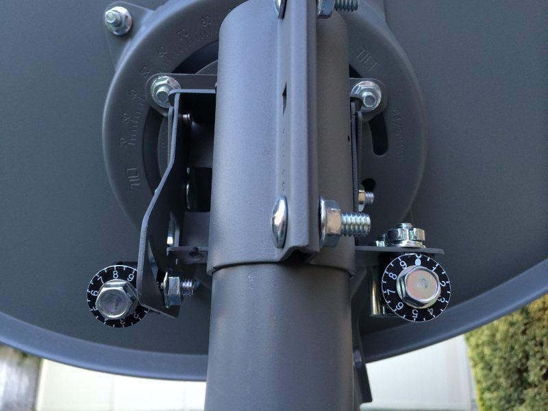

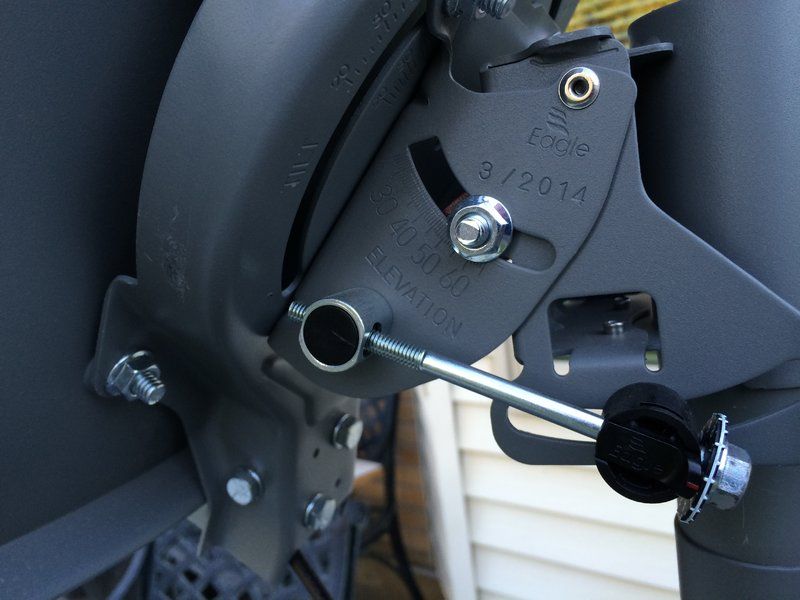

The good news is that my dish has some nifty adjusters on the back of it which allow me to really fine-tune my settings once I have identified the satellite. Rather than loosening and tightening nuts & bolts, I can use a nut driver to turn a couple of adjustments screws (one on the elevation and the other on the azimuth), and it makes micro-adjustments that were not possible with my old setup. Including a pic if anyone is interested.
I feel like I am set, and will probably rent a small portable generator (inverter) and haul my equipment to Fish Lake for a day sometime this week, and see if I can get some success. I will report back to let you all know how it went. Again, thanks for your active participation. You've helped me a lot.
Those small knobs are for dithering, which is the fine tuning of the dish. You did exactly what you should have!

Don't forget, when you dither, you DO have to loosen the Correct bolt, make the adjustment and tighten back up again .... :)
