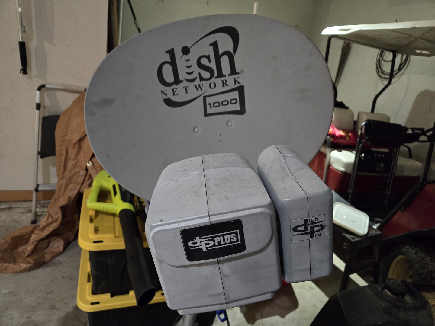

Ok, it's been a while since I had it out. It was installed on our house, we originally had 2 dished before we got our Hopper.
The big one is a DishProPlus twin I believe it's called, depending how many outputs it has you can run one receiver from each. The little one is for 129 which is not in use anymore so you don't need it connected to anything. That might have been run thru a DP34 switch back in the day when 129 still was in use. If that's the case and you still have it, it will support 4 receivers - if you don't have enough outputs on that twin.

I misspoke in my first post it's the 500+ that's international not the 1000+. I haven't messed with one in a long time.
So, with your setup there's only two out ports. So to run a third wally, yes you'll need a switch. Or can call dish to add the wally and the tech will end up putting a new dish most likely.
If you're set on doing it yourself though the 34 switch should be fine. As mentioned already you don't need the the smaller lnb anymore so can just disconnect that. Then two wires from the outs on bigger lnb to two inputs on 34 switch then connect each wally to the outs on the switch.
As far as the signal meter on the wally making a sound, go to where it shows it under system info then dish then where it says tuner, select that a few times and the sound will come on.
