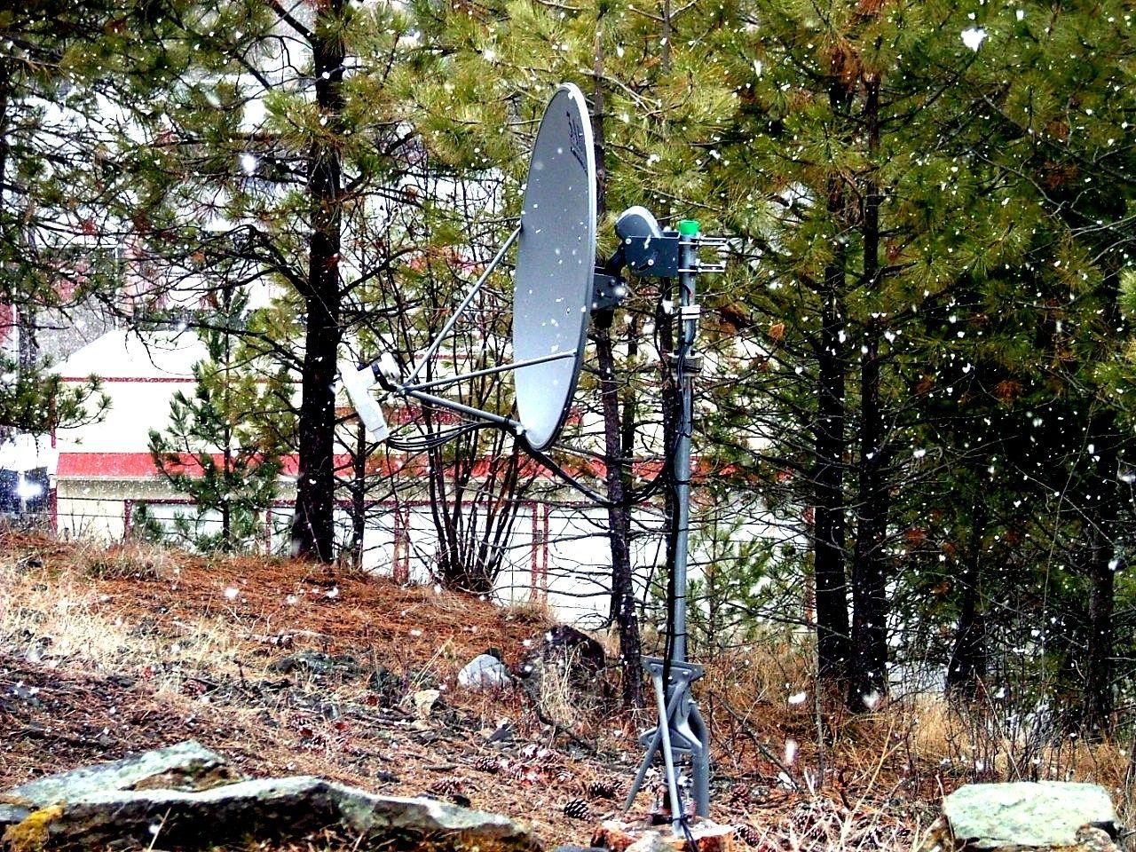

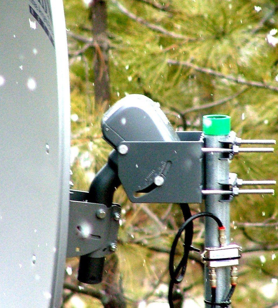

I received my powertech DG-280 a few days ago and thought I would share my impressions of the motor. The motor is very well built; the mounting hardware is heavier built than sg 2100 which I like. The motor comes with the larger mounting tube so I ordered the smaller one for my dish, changing the tubes was a breeze. The smaller tube fit perfect, there was no issue what so ever with the holes lining up. I mounted the motor and dish to the pole and set it up on my true south sat with a meter and then hooked it up to a CS 6000. I set the motor up using USALS and it worked great, I noticed the motor is louder than the sg2100 but I expected that. I didn't have any of the issues with this motor that I had with the sg2100 hooked up to a CS 6000.
I received my new visionsat a couple days after I got the new motor, I hooked up the visionsat to the DG-280 and set up the USALS and works like a charm. I've run the heck out of this motor the last few days and so far (knock on wood) no issue's what so ever. I'm very impressed with this motor; I attached a pic of the motor mounted to the dish and pole, it was snowing when I took the pics so that's what that white stuff is. LOL. I hope this helps someone that might be interested in this motor.

Thanks for posting back your findings, this is helpful to me, I'm shopping for a new motor for this spring. Your setup looks a lot like mine, looks like an Invacom quad on that dish? You said the 280 is noisier, is it a lot noisier? My neighbors are close and in the summer with the windows up, its probably annoying as it is, I don't really want something really noisy.
When the motor is moving on H TP it's pretty loud, my dish sits about 30 feet from my front windows and I can hear it. When it's moving on a V TP it's not that bad at all. I like the extra noise because it keep's the deer away from my dish, LOL. For what ever reason they like to lick the Invacom LNB, maybe they think it's a salt block. LOL. Night time might be your only problem with the noise from the motor.
