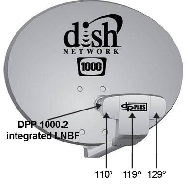

As you stand behind the dish, the 129 LNB is the leftmost and the 110 LNB is the rightmost. 119 is the middle LNB. Foil over the outer LNBs. Set skew and elevation. Find 119 on the unfoiled center LNB by moving the dish slowly back and forth. If you don't detect a signal, adjust the elevation a couple of degrees up or down and then back and forth to the east and west until you find 119 on the center LNB. If you aren't finding it on the center LNB, it is likely because the elevation is off. Once you find 119 on the center LNB, adjust the elevation and azimuth to get the highest signal strength on a ConUS transponder like T19. Then unfoil the outer LNBs and do a Switch Test. Hopefully all 3 positions will now be received and you can tweak the dish if needed to max out your signals.
I'm just adding a picture of the 1000.2 dish so you can understand the lnb better. Laddyboy covered pretty much everything. :)
