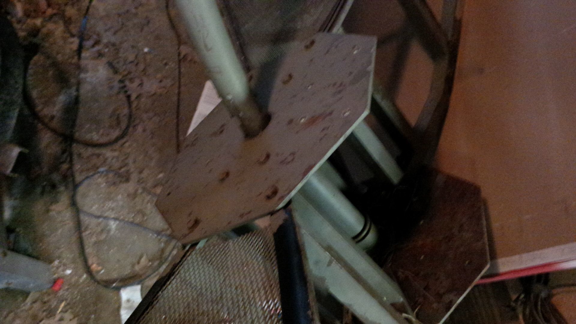

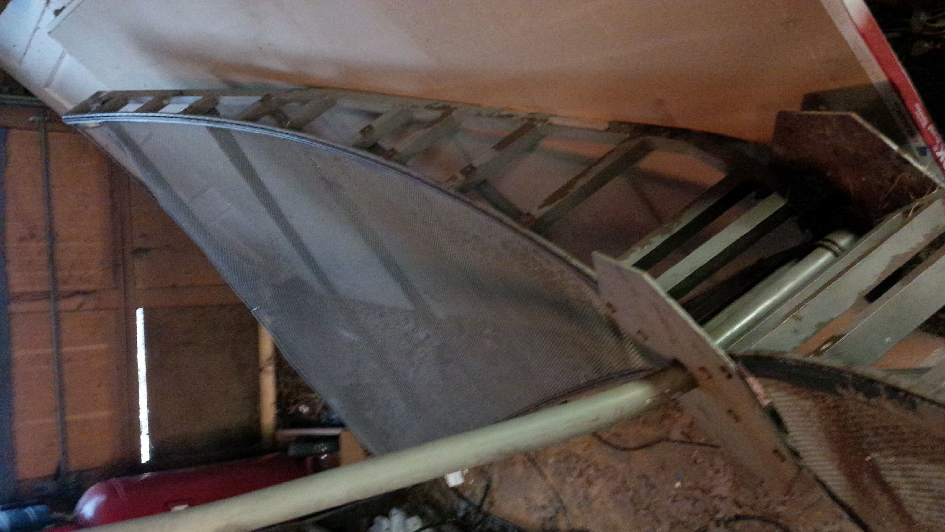

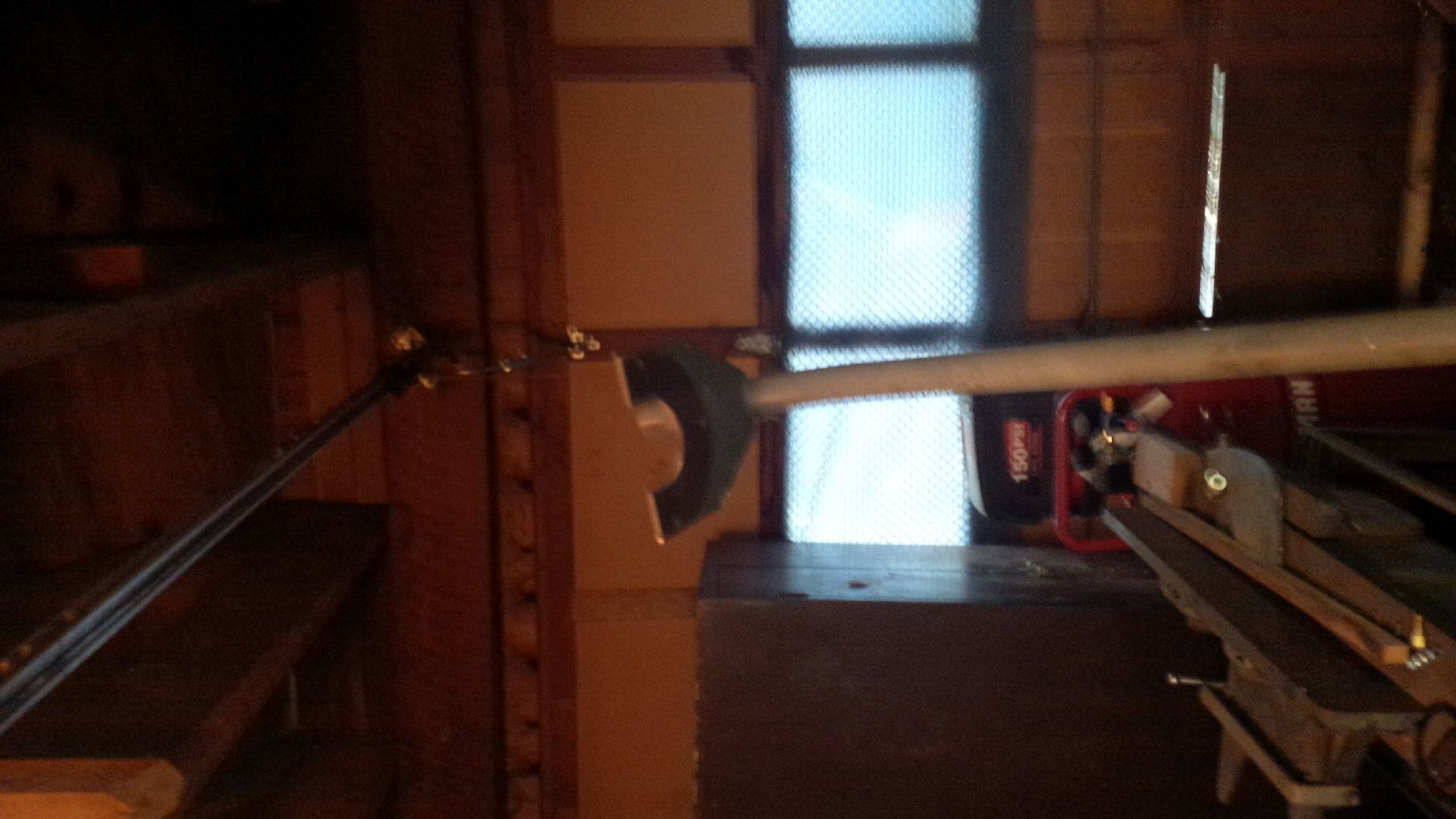

Hey guys. I've been lurking in here a long time and I have learned enough to successfully setup my ku band dishes without asking questions. This forum is great. I recently collected a 12' mesh dish that was laying in someone's back yard. It isn't in great shape but it is structurally in tact and the mesh is in good shape.
I need help identifying the thing so that I can get it back in operation. This thing is going to my camp where I get 72w - 105w (Cameron County, PA) on the KU dish.
I am hoping someone here knows what this is so I can find a manual or instructions for it. The previous owner knew nothing about it because he just kept bringing parts and asking me if I wanted them as well. There is also an L-shaped bracket and a polar mount that are not pictured. If I get a nicer day I will try to drag everything out and take some better pictures. The previous owner had taken it mostly apart but it appears all the pieces are available. I may need to replace some bolts.
There is an unlabeled actuator and a Chapparal feedhorn with a Mag-7 LNB that were also included.
Any assistance or suggestions would be appreciated.
Thanks in advance.

I don't think I have quite that much work to do on the panels but I do have a mount issue. From what I have seen around here and other places I believe I have a polar L mount. I am debating if I should bother to look for the right parts or just fabricate those parts. I am guessing I will get the parts a lot sooner if I fabricate.
I saw some pictures on another site that showed this dish mounted to a square pole. If that was the standard for this Polar L mount I may have to make something anyway.
I have another polar mount that is round and seems to be more common to large dishes. It wasn't built for this dish so I think that modifying it to fit may cause me alignment problems when I try to finally setup the dish.

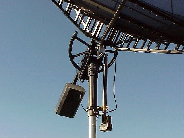

The Paraclipse post mount cap was a thick wall 4" square pipe about 2.5 - 3 feet long. It was a heavy beast, but certainly would never fail! :) This square post sleeved over and tension bolts secured to the in-ground round pole.
That is what I saw in one of the other forums. I didn't realize that whole thing was a sleeve. I bet that was heavy. I asked the guy who had the dish if there was anything else that went with it. When I looked at what he gave me I knew there was going to be a missing mount piece. Do you think it would just be easier at this point to fabricate a round sleeve with the appropriate bracket piece on top? I believe I can replicate that fairly easily. I don't know that I want to make the sleeve quite that long. It seems that the L bracket has a tension adjustment that linked the back of the L bracket to the sleeve. From what I have seen both here and in other pictures from other sites there are a number of different ways that the elevation setting was accomplished. Are these setups some aftermarket modifications that the owners did to make setting the elevation easier or did Paraclipse just have different designs over the years for this mount?
The pictures here: http://www.satelliteguys.us/xen/threads/i-finally-did-it.324460/
As compared to this one: http://www.fridgefta.info/forums/showthread.php?tid=26895#axzz34QwuBNTq (I hope this doesn't violate rules but I didn't want to just grab the photos without attribution.)
The second seems to have been modified in a few ways. I don't think that my L bracket has either of these setups.
There were several elevation designs and also clone Paraclipse dishes. I owned the type shown in the 2nd link. It had a critical poly sleeve that inserted in the AZ rotation assembly. Without this sleeve installed, the mount had considerable slop.

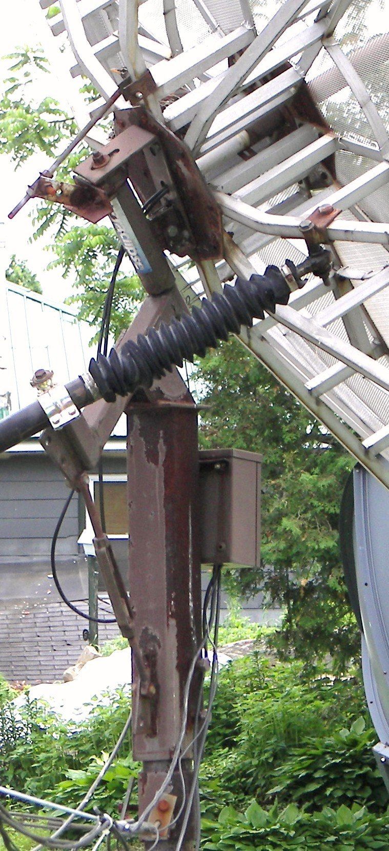

Here's a pic of the back of mine.As you can see,I cut about 3' off the square tube,couldn't get it up on the pipe otherwise.Then used a piece of the cutoff to make the guy wire collar.I made the adjuster on the top for setting declination,the original design wouldn't hold after the ice storm in 1998.Put the dish up around 97,came from just down the street,had to take it completely apart to get it down from where it was.
And yes that is a robin in a nest,they don't seem to mind going for a ride once in a while :biggrin.
