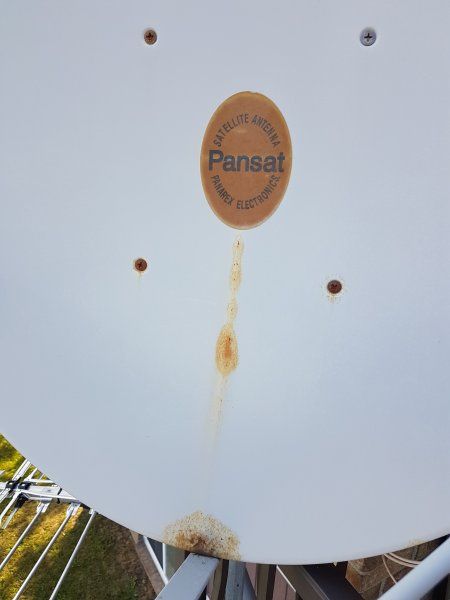

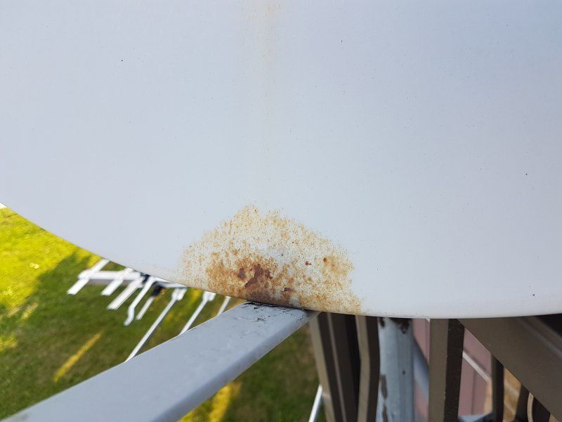

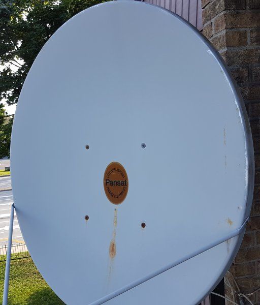

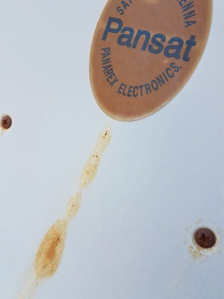

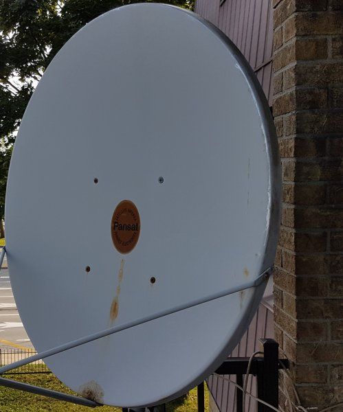

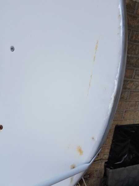

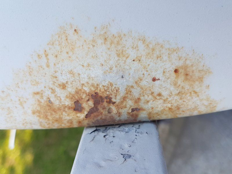

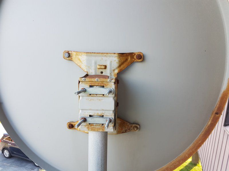

I've uploaded some pics, is the bad rust you're talking about? what do you think?

Nice dish [emoji1]. The rust shouldn't be a problem. Make sure to do a warp test by laying one string horizontally and by laying another string vertically. If they touch, they you'll be good to go. If they don't, you'll need to find a way to "dewarp" the dish.

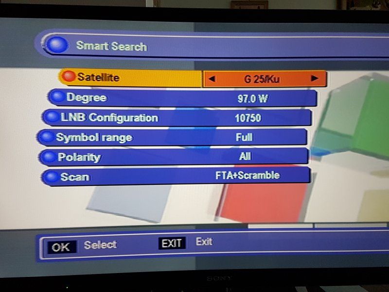

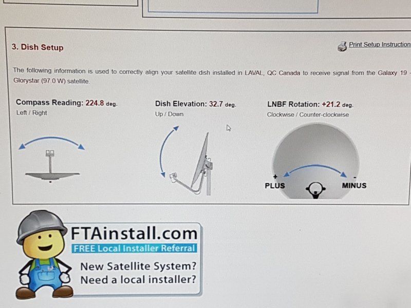

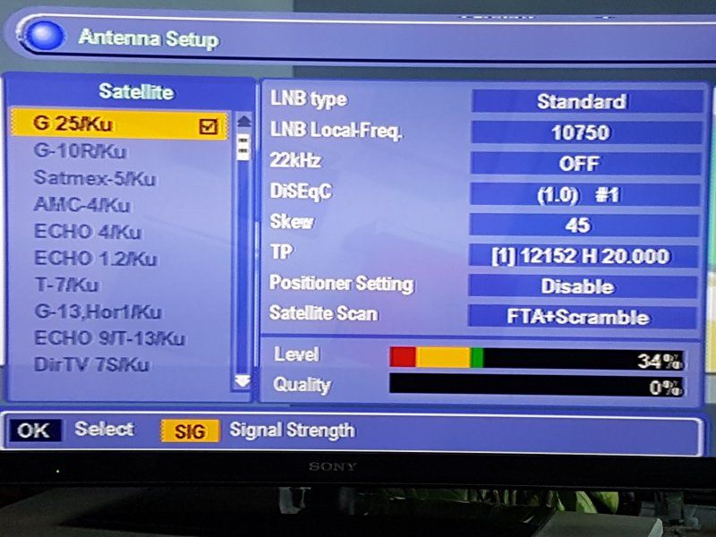

I just installed the GEOSATpro SL1PLL - 0.5 Linear HD LNBF I bought with the old dish (pics above) however I'm not getting a signal. I've pointed the dish in the right direction, the right dish elevation and I'm not getting anywhere; for the signal reception I get a low 34% for the level and a constant 0% for the quality. (I'm trying to tune into Galaxy 19: 97.0 West)
These are the diagnostic steps I took:
1) As mentioned I bought a new LNB, I got no result with that.
2) I went on sites, such as, GeoSatFinder.com to find the correct aiming coordinates for my place, I got nowhere; I moved the dish in many positions and then quality stays 0%.
3) I turned the receiver on and off many times and I did a factory reset; that did nothing.
4) I went online to make sure the LNB frequency and transponder numbers were correct; my research showed that they were correct; I played around with different TPs, and the quality stayed at 0%. I read that TP 12152 is underwhelming compared to TP 12090; so I changed it to the latter and that did nothing.
5) Then I thought, maybe the signal is not getting through the coaxial cable properly. When I removed the satellite cable from the receiver the signal level went down to a constant 32% with no fluctuations at all, when I put the satellite cable back into the receiver the signal started fluctuating from 32% to 36%. I'm running an OTA antenna and a satellite dish through the same cable using diplexers on both ends. Therefore I removed both diplexers and ran a straight cable from the dish into the receiver, again that did nothing.
6) On my receiver Galaxy 19 is still named as Galaxy 25, however the degree is correct, 97.0 West; so I know that's not the issue.
Any ideas on what the problems is? I have attached 3 photos from my tv screen to show you the satellite info. Are the numbers on the antenna setup page correct?

The signal level only tells you if your LNB is working or not. Are you out aligning with your TV, or do you have a helper to tell you the quality readings? Are you using a DiSEqC switch? If your not, then you should set it to OFF.
I am using a helper to read the signal levels, but I can still see signal levels from the screen door. I've tried switching the DiSEqC switch off before, but that hasn't worked; I 'll go try again.
I just switched it off, but no result.
If you check the picture with the aiming coordinates, it says the LNBF should be turned at 21.2 degrees, I tried both the 0 and 21.2 position, but no result.
All your settings seem correct, so its just a matter of sweeping the sky untill you find a signal. Turn off the DiSEqC on your reciever. You wont find anything with it on. Also,set the skew at 21.2 degrees. Make sure that you have a unobstructed view of the southern sky. I'd reccomend using an phone app to check your LOS and to get a general idea of where the satellite is.
