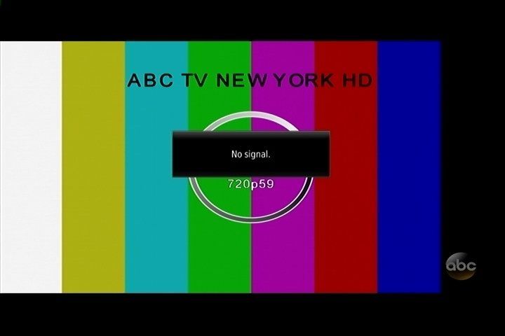

Hi Folks,
It's ME again. : - ))))
I do not know how to explain this without pictures and
in person. : - ((((
I knew this might be of a problem.
I wish that IF any of you were to be,locally to check
the servo motor on my feedhorn.
Just found out about trying to get ABC Network feed on
Galaxy 16 C-band. Whether IF it the Satellite AV
GEOSAT PRO HDVR-3500 receiver, or is it something else.
I spent all of this afternoon,ON Thursday December 14th.
I decided to look at another possibility of why I'm NOT just
getting ABC Feeds on Galaxy 16 C-band satellite and got
most of the channels on it.

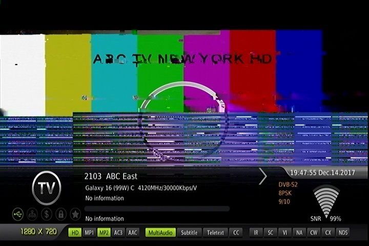

I took a long broom to reach at the feedorn, and I tapped it
onto the dome cover, and on one of the legs that has cables
tied up into the dome cover to the feedhorn.
And guess what???? I only got the frame of ABC Feed
color bar tone, but NOT 100 %. JUST MOSTLY BREAK UPS
audio. and weak video.
I was able to hear the feed by using a FM system, which I use
pocket receiver with an ear bud, and the transmitter with a microphone on
the TV speaker, inside the house. : - ))))

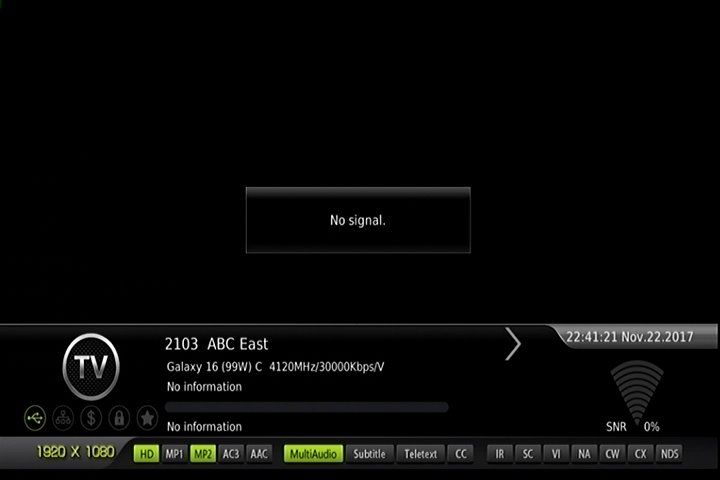

IF I change the channel on the GEOSAT PRO HDVR-3500 receiver,
and back to ABC feed, then it will show blank and say
"NO SIGNAL",.
So, I'm thinking IF maybe either the receiver itself, NOT getting any
voltage. Or the servo motor on the Co-Rotor II feehonr, in the dome cover.
Remember I'm connecting directly from an LNB to the GEOSAT PRO HDVR-3500
receiver. NOT splitters or any devices in between.
This is directly from an LNB.
I even tried with the splitters and the devices that I have been suing,
shows the same results, able to see a frame of ABC feed color bar
tone, audio break-up.
IF any of you would like to see a short video clip of ABC feed color
bar tone break-up, please PM me, and I would be happy to upload
to you from my GMail. The short video clip is also a big file.
Other than that you can see the photos that would give you an idea
of what I'm talking tbout.
I wish I knew saomone who would be willing to go up on my ladder to the
feedhorn to look into it on the servo motor and the wiring, while aiming at
ABC Feed on Galaxy 16 C-band.
I CANNOT DO THIS MYSELF. : - (((
But what I did the best I could, was while I got the frame of ABC
feed and audio break-up, I tried to elevate the dish both up and down,
and declination bolt.
NO DIFFERENCE!!! IT DI NOT HELP TO CLEAR UP ABC FEED.
Still audio break-up and frames of the feed,
I have a 6 foot ladder and a 12 foot ladder, but I do NOT want to fall!!! : - (((
I'm going to try suing SKYBOX F3 receiver, which is ONLY A TEST
RECEIVER. Maybe this weekend or so, to see if that makes any
difference, before I make a decision on whether which problem may be.
Hope all helps with answers.
Thanks,
ECruzBUD

Your on the wrong polarity. According to your 002.jpg your on vertical. These feeds are horizontal. It scans in ABC-1, 5, 7, 11 and for me running at 14.7 dB. Gotta look at the basics before twisting yourself into a frenzy.
