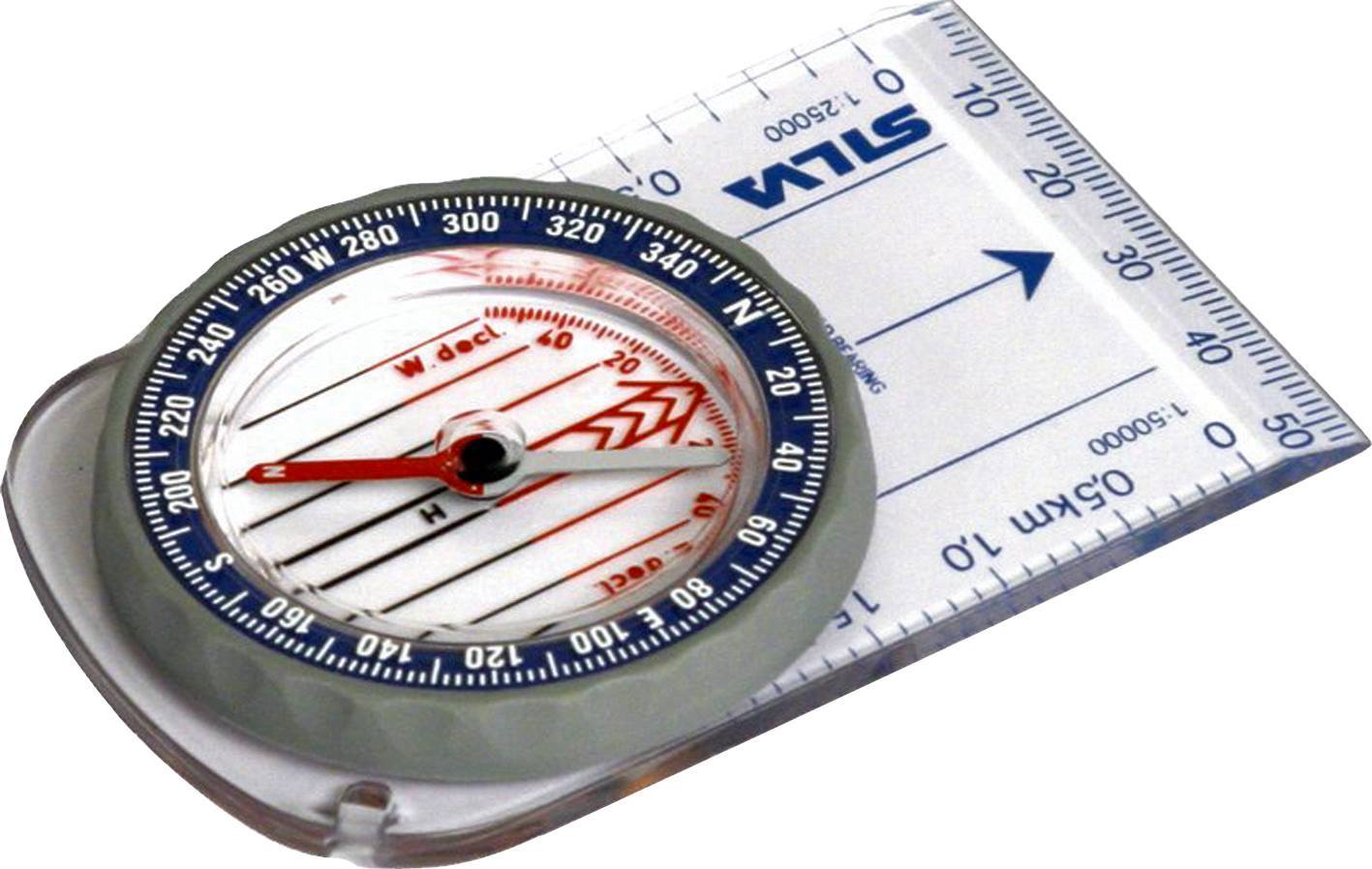

Receiver/dish setup, the correct coordinates and a $12 compass is all you really need. Should be golden in about 20 40 mins depending or your skill level.
Good luck and let us know how it works out. Here is a pic of what I used.
