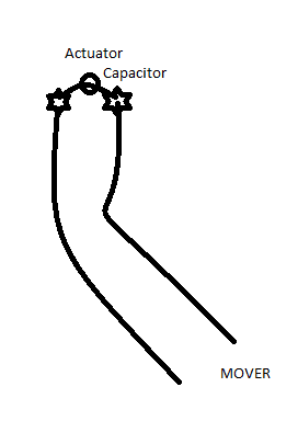

Just to confirm, I am supposed just connect it between M1/M2 at the actuator. I do not inline it, ie i do not connect it in series.
Connected Like This
