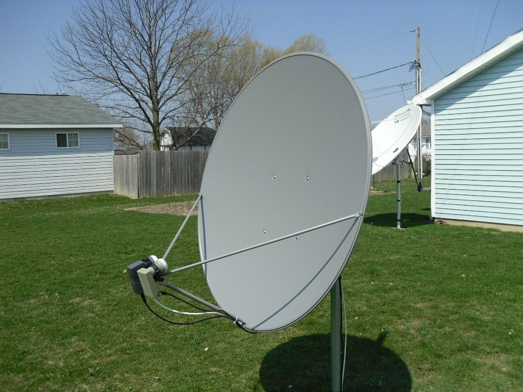

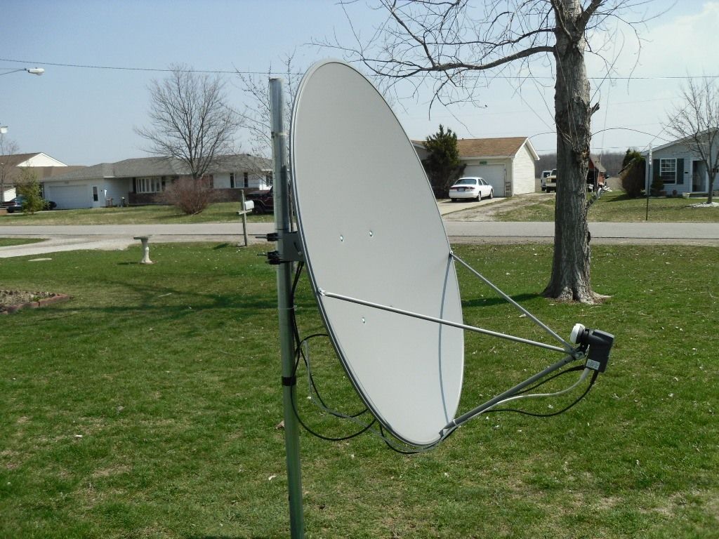

Thanks for the great deal Brian. The dish was delivered Thursday, opened the box last night and installed it today
on a new DG380 motor. The elevation adjustment was easy with this design. Was in a hurry and only spent about
15 minutes adjusting it. It replaced a 90cm dish and good improvement, especially on S2 signals. Nice solid dish
and good finish. Thanks again.
Hindu55 (Jim)

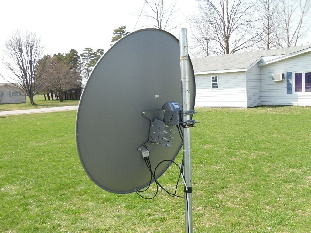

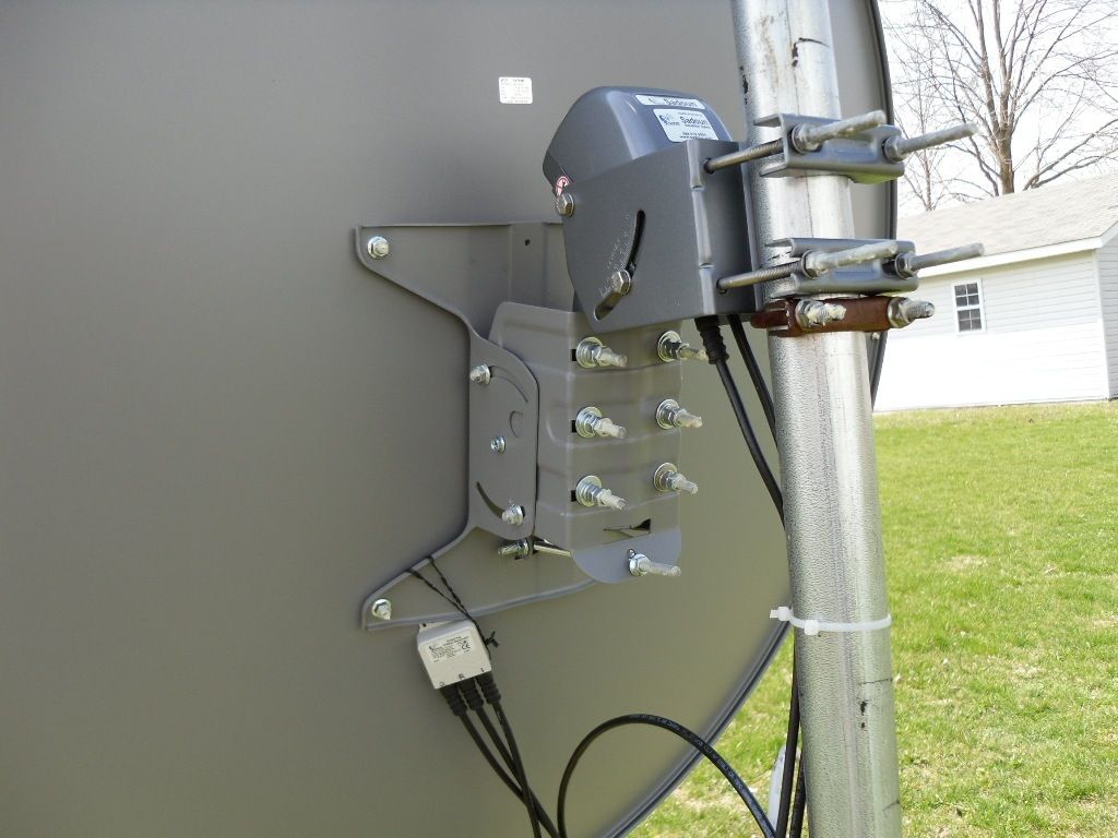

Pics of the new GEOSATpro 1.2M. I picked up three U-bolts at the hardware that were smaller than
the originals. They just fit the bracket and fit more snug against the motor tube.

Thanks for posting up the pixs! Looks great!
What size tube is on that motor, 42mm? What size u-bolts did you substitute? Is the second offset LNBF for circular or the 103W skew?
Motor tube is 55mm. U-bolts from Ace hardware said for 2 inch pipe. They measured 2.5 inches I.D., 5/16 thread. Just fit the openings in the bracket.
Second LNBF is Circular. The S2 on 103W Storms in with normal skew. :-)
I like how you added a U bracket under the two U brackets used for the motor. This makes it easier to adjust the motor and to add extra protection in case the motor slips.
Thanks,
Had that under the 90cm setup also. After pulling my hair out trying to adjust it, I added the u-bolt.
