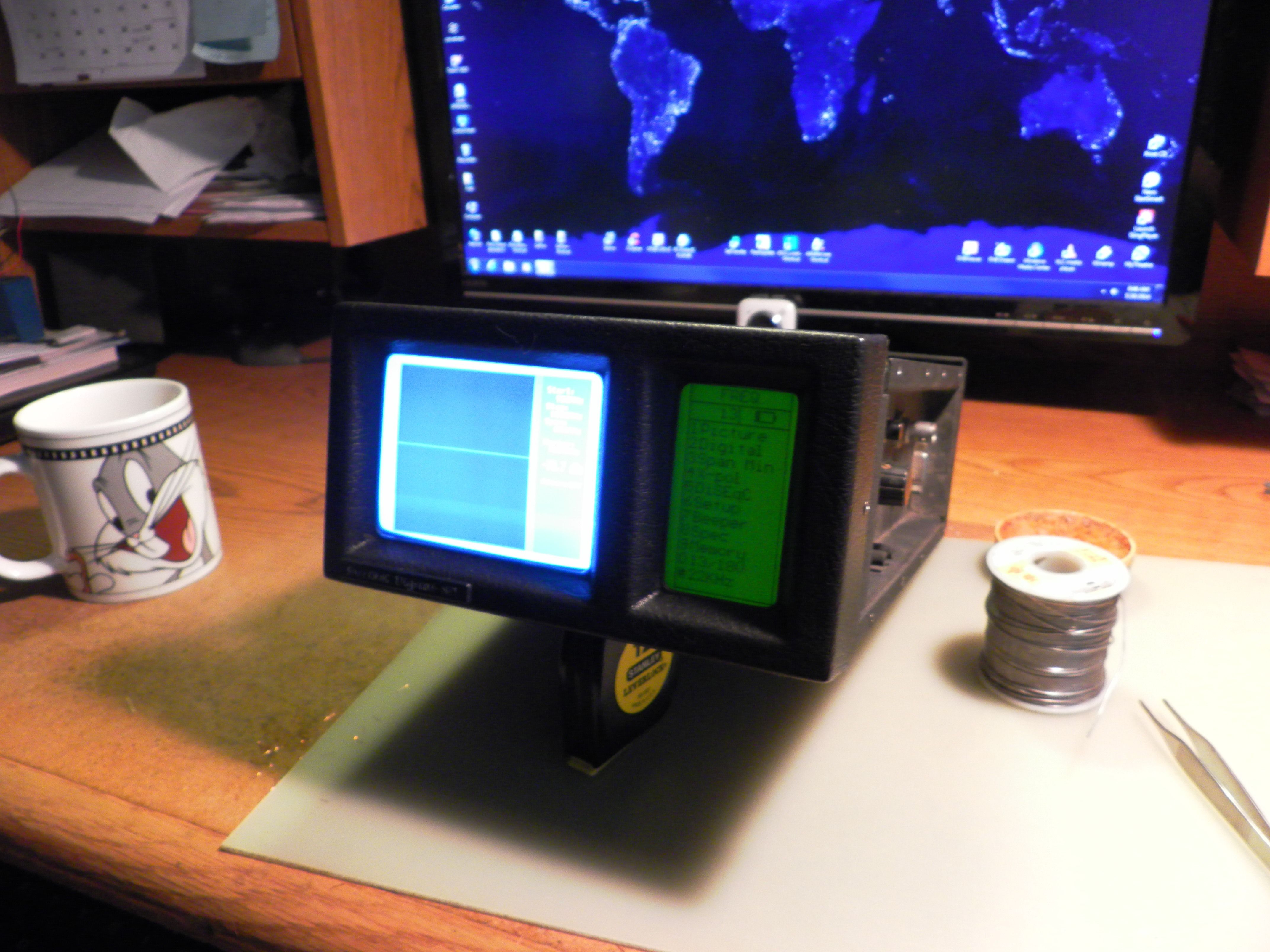

I have an old Satlook Spectrum Analyzer from Sweden. It no longer runs on the internal battery(good battery). External power only. I opened it up and found a bad power mosfet was the problem. My problem is, I'm not that smart at identifying electrical components and finding suitable replacements. It has a "Fairchild" SFR9024 Mosfet. So far I've been unable to locate this part under any brand name where I don't have to buy hundreds of them. But there are so many variables in picking a replacement mosfet, I'm not sure I can select an appropriate replacement. So if any of you electrical gurus can pin point me a replacement component I would be very grateful.
Its obsolete. Looks like FQD11P06 is a good match with lower resistance and higher current rating. Available from Digikey. Good luck!

Wow, this thing is cooked. There is a divot burned into the circuit board where the mosfet mounting pad was. This may take a couple of Band-Aids on top of everything else :frown:
Thanks guys! It was just the ticket. Were up and running :)
