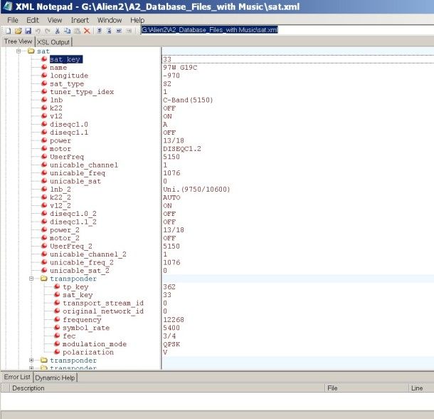

Unfortunately I'm using a Icecrypt S3750CHD and one of the only drawbacks with this receiver is when you select DISEQC 1.2 on the motor option it gives you only a 'save' button after you gross tune and fine tune the position. So I have no idea what number is being saved to the position. Every other receiver I've had including the computer cards allows you to assign a specific position on the 1.2 motor menu. I've seen this as a fault from others that own the receiver as well over at Rick's. I've got a question into Icecrypt and I sure would like them to rewrite the firmware as that way I could just ditch the vbox remote all together.

I don't have an Icecrypt S3750CHD but from what I've read, it's an updated version of the Amiko Alien2 with some additional features. It still dual boots to Spark software or Enigma 2 if you choose and the latest screen shots I've seen show it has the same DBase, Kernel, and U-Boot versions as the Alien2. Its system firmware version is 1.2.86 instead of the 1.2.83 my Alien2 runs.
If the satellite setup is the same, the DiSEqC 1.2 position number it saves will be the same as the satellite number in the satellite installation menu. That's also the sat_key entry in the database.
I've had no problems at all with either DiSEqC 1.2 or USALS motor control on the Alien2 in the 4 or 5 years I've had it and I haven't heard of issues with the Icecrypt either. You just can't choose the position number you want to use.

Noob question here. How do I FTP into the box in order to see the XML for the satellite locations? External networked computer using the DHCP IP number and a specific port number or something? The manual is a translation from Chinese to English and leaves a lot to be desired. LOL

Got it all figured out. Thanks for the help. Also figured out how to FTP into the box and can see the Linux structure and where everything is kept. Now that the receiver is controlling the dish there is one less remote to mess with. LOL
Glad you got it figured out Arion. I seldom FTP into the box. Generally I just use the database transform function to export the database xml files. After saving a backup copy and then making the desired changes to the applicable file, I use the database transform function again to import it back into the receiver.
