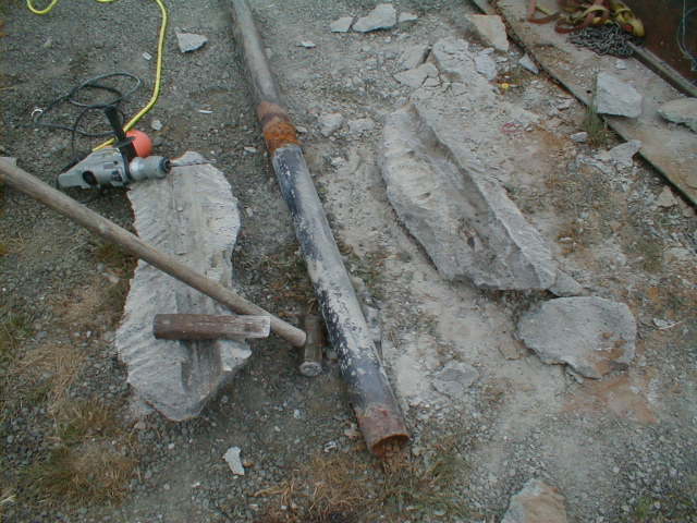

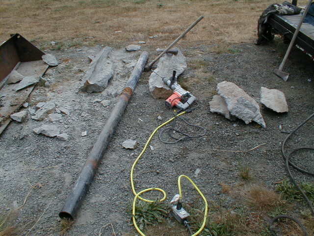

Before I started sawing off the upper piece, I got out my sledge hammer and took a couple swings. It was solid but as I worked from the edge I could knock of pieces the size of my hand. Next I got out my faithful H/F hammer drill. I started drilling a row of holes about 1.5" apart. Each row 45 degrees apart. I then cleaned out the web between about 3 holes for my log splitting wedge. A couple swings of the sledge hammer and it was quartered, right down to the pipe. The rest came off with the second split. Took a couple hours to drill all those hole. (1/2" dia works best so the wedge seats early)

Here are a couple pictures of the post, after demolition.
Not a bad couple hour work (I'll be 72 tomorrow ;))
