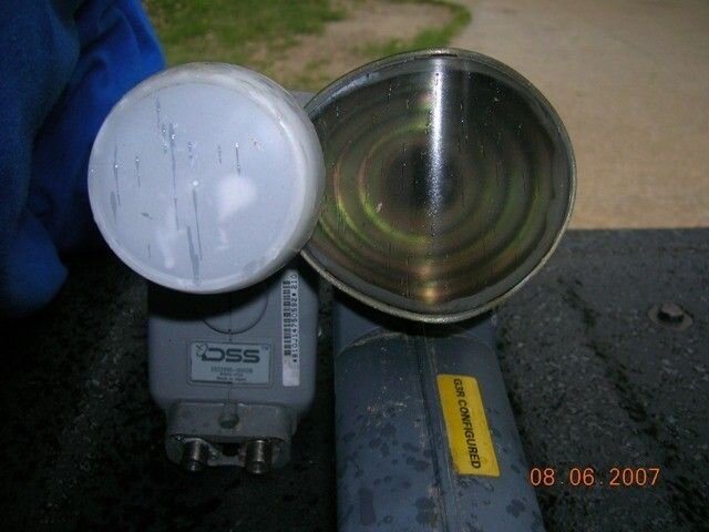

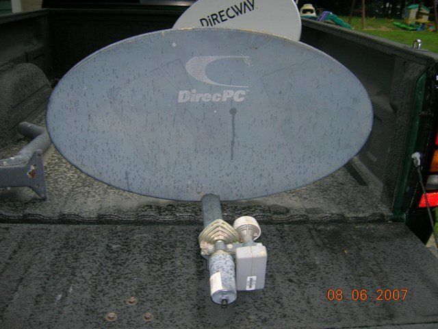

Hi, I couldn't pass up the free sign on these 2 dishes this afternoon. The direcpc is a little smaller, 35x20 and it came with a second lnb attached. The main lnb is kind of weird, has a V shave to it. even though this is a little smaller will it work for 123W? I was thinking I could swap out the attached lnb for a linear one to pick up 129 also. I would rather use the direcpc if I could since it came with the standard angled pole mount and doesn't require the 3" pole like the direcway - also seems lighter so I could get away with mounting it easier. I am in NH and in the rain I have a little trouble sometimes with 123W on my 30" dish so I wasn't sure if this one would do the job or not since I would like a fixed for 123W and the motorized one to play around with.

I have one of those (same setup) :)
It is decent for G10...I wouldnt say spectacular but it gets the job done. I tried it once on G10 here in MN (45N) and signals were a little lower 9at the time) than my 36" dish...36" had 75/40 (11800 TP/11720 TP) and that one had 60/35. This is when the 11720 TP had issues.
I did use it on my StarChoice setup for 107.3 and it worked really well on that :)
