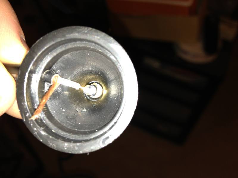

Cheap ANT that comes with. Easy to remove with station.

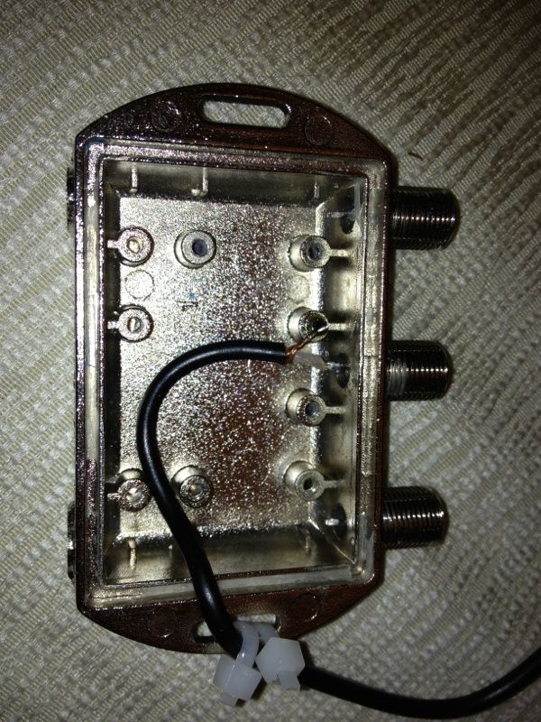

Wire removed from "crap ant" used a 2x1 case for the f pin.

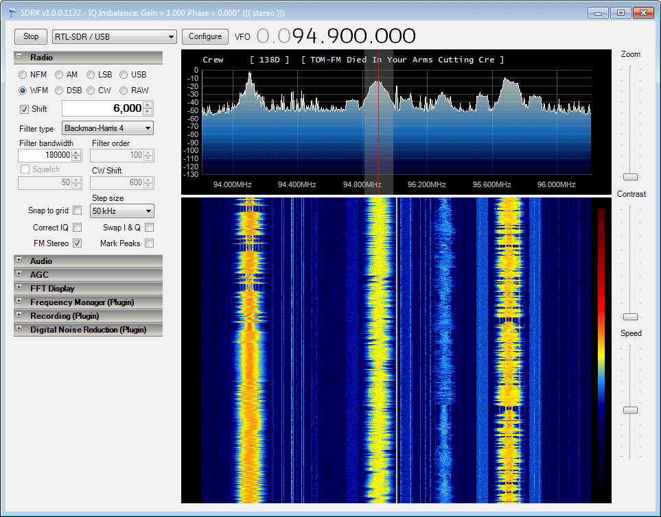

I received my tuner dongle today and fired it up! Here is SDR# decoding one of our local FM broadcast stations :)
cool! I see you have the same issue I do, if you notice in the center there is a peak and a line, and its directly in the center and is there no matter what frequency you are on. I wonder what causes that?
Yeah, I noticed that too...whatever it is, it interferes with reception if it's within the signal I'm trying to decode. This is one of the R820T tuner units which isn't supposed to have the dc spike (the earlier e4000 tuners did). Maybe it (and alot of other noise from my office/ham-shack) will disappear once I use proper connectors...right now I'm using an alligator clip to the center conductor of my OTA coax :D
The spike isn't present when I use it with Gqrx in Ubuntu linux on a different computer (an old Dell D610 laptop), so at least it's not the dongle itself.

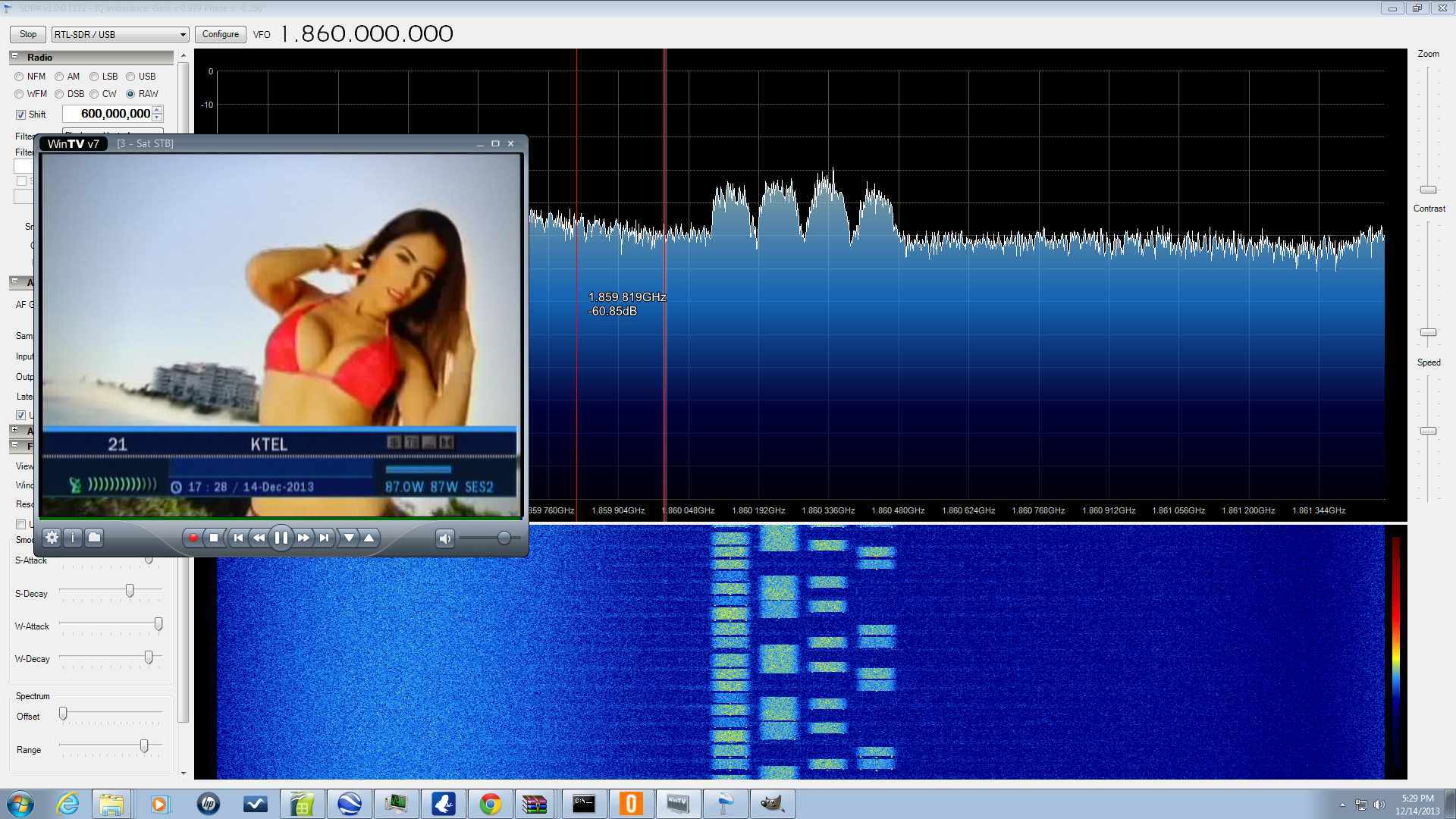

Here's an SDR capture from 97W in the neighborhood of 11860H (I'm using the LNB-out from my VisionSat rcvr), as well as one from KTEL :cool:. I haven't a clue what the signals in the SDR display are yet...telemetry, packet data bursts, etc.?
