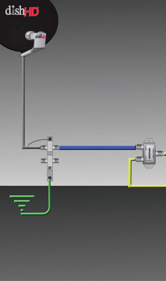

I run solid ground wire connected at a mounting bolt, usually 10 gauge, down to the service panel ground if convenient, or a new ground rod if not. An alternate ground would be to use a standard coax ground block where the coax enters the house, but that depends on the lighter gauge braided shield. Ground blocks should always be used for normal installations anyway, although they're impractical for portable installations.

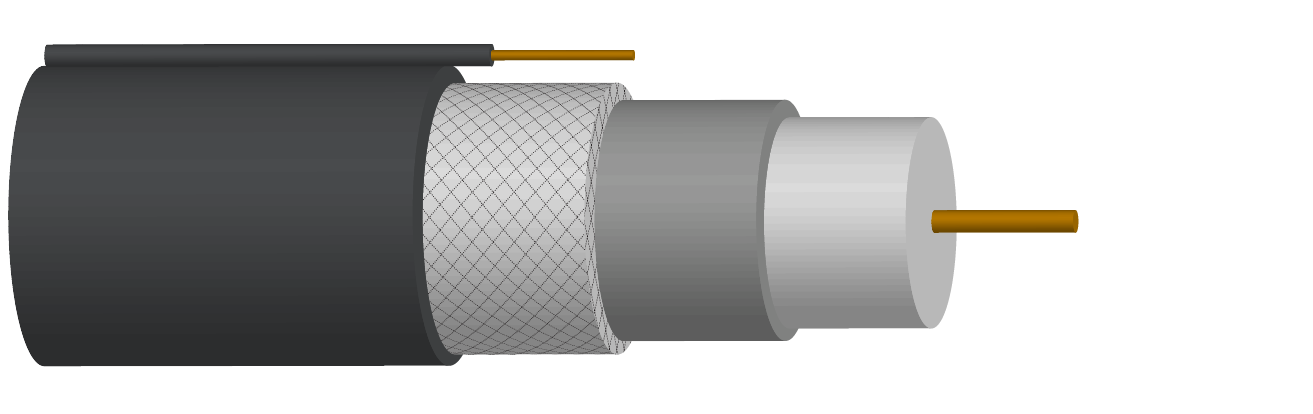

The cable coming from the Dish is supposed to have a messenger line attached that bonds the dish to the ground point on the house or in the basement, using a ground block, if that's where the cable runs, then from there a ground wire to a ground point
I know that's the standard grounding requirement, but for roof peak and chimney mounts, I prefer to run a heavier ground.
I can't fault you for that, I'm just curious what your reasoning is, specifically as a learning tool.
My thinking is that roof peak and chimney mounts are more exposed to near miss lightning strikes, so I prefer a heavier duty ground path as direct as possible. For a direct hit of course, all bets are off. Living on a mountain top for 10 years taught me a lot about the odd things that lightening can do when it hits near by and smaller forks hit closer.
