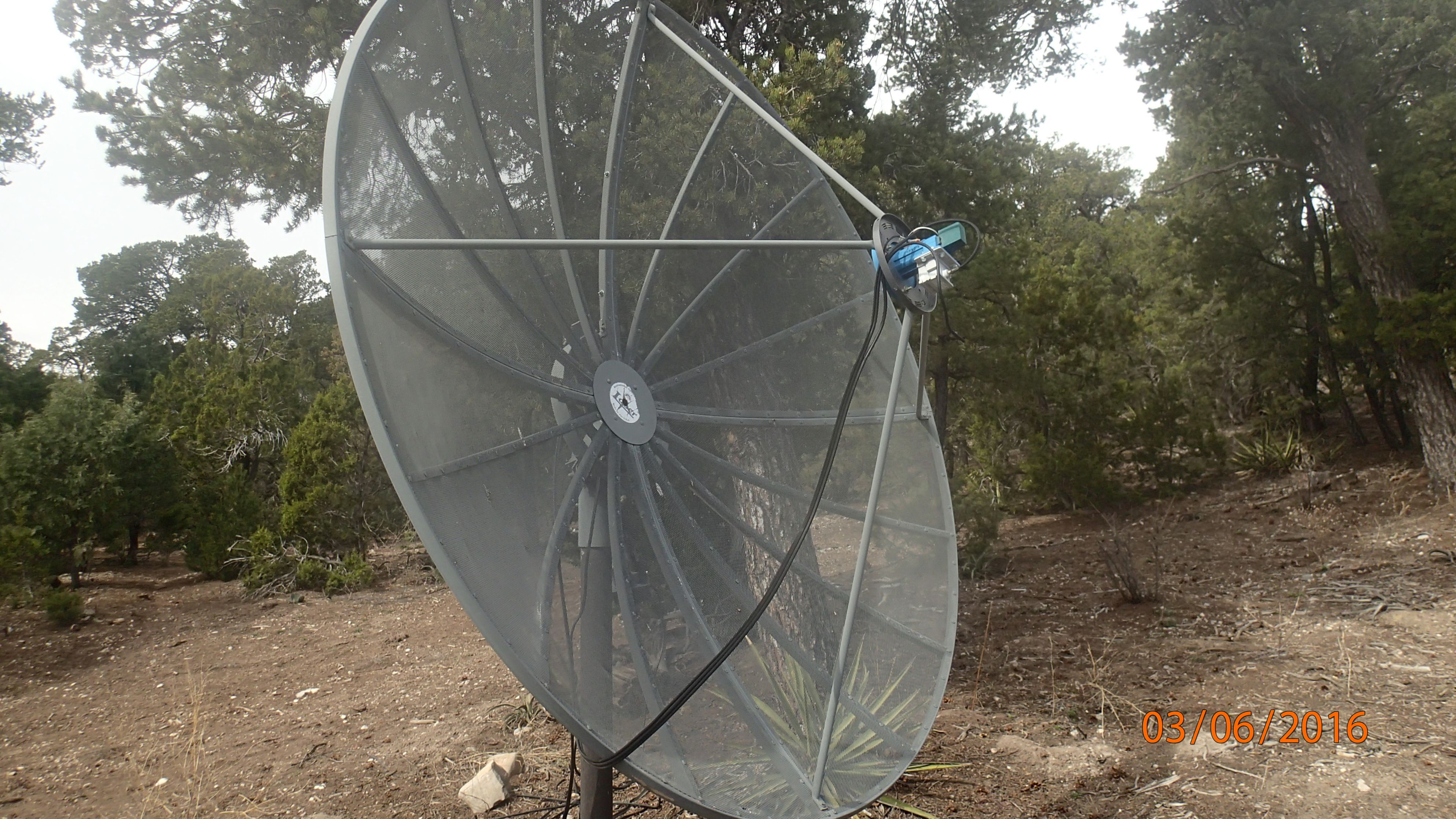

I recently disconnected my pay TV service. I have this equipment sitting on my property. I am wondering if it can be used if so how? thank you for any info.

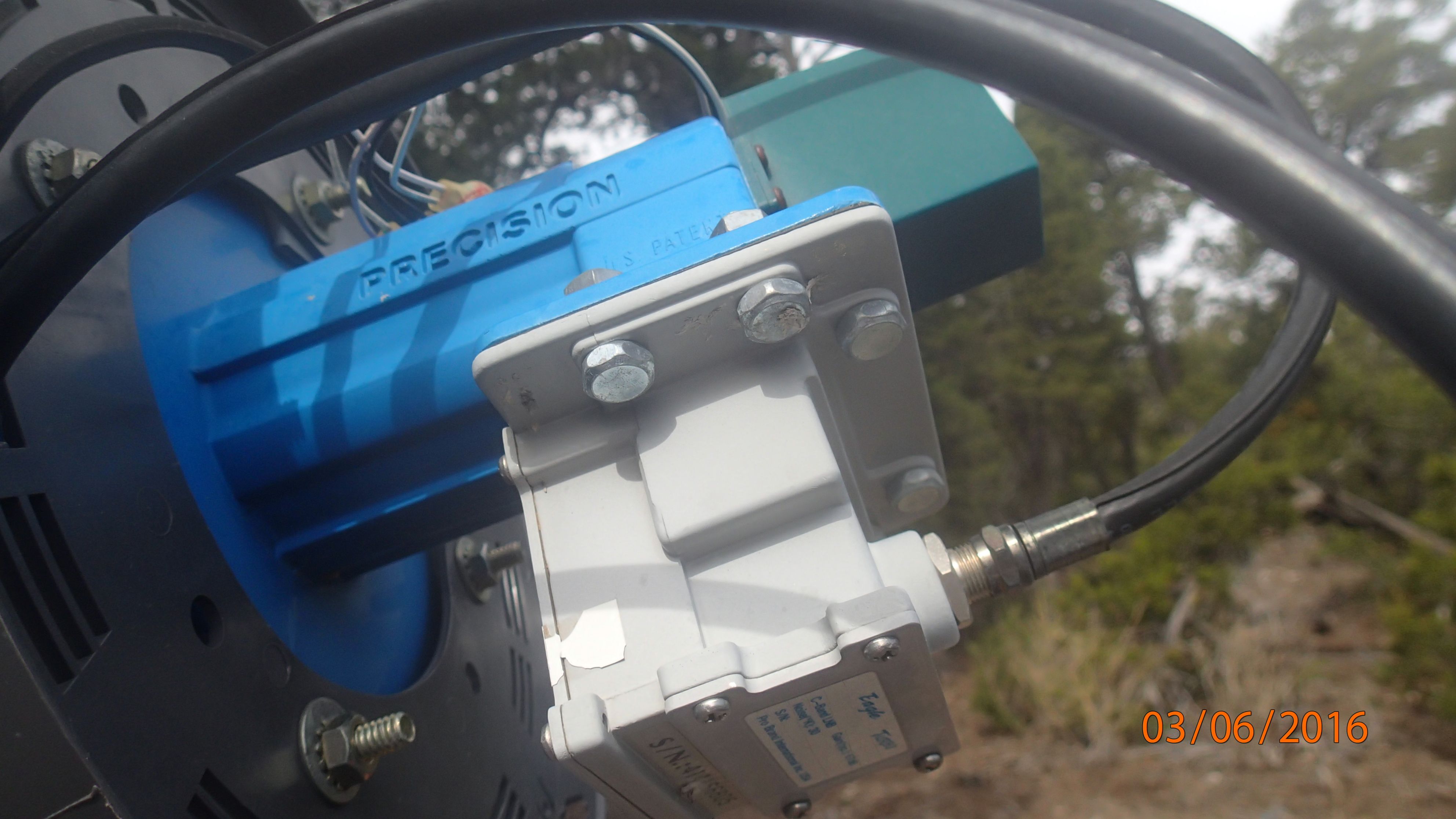

With a minimal investment of about $150, you will be able to receive hundreds of free channels. If the motor still works, you should only need a DVBS2 satellite receiver, a motor controller and simplify things by replacing the electronics on the dish feed with a LNBF.
Depending on how much of the sky that is visible from the dish location and not blocked by trees, you will be able to receive dozens of satellites in an arc from the eastern horizon to highest in the South and to the western horizon.

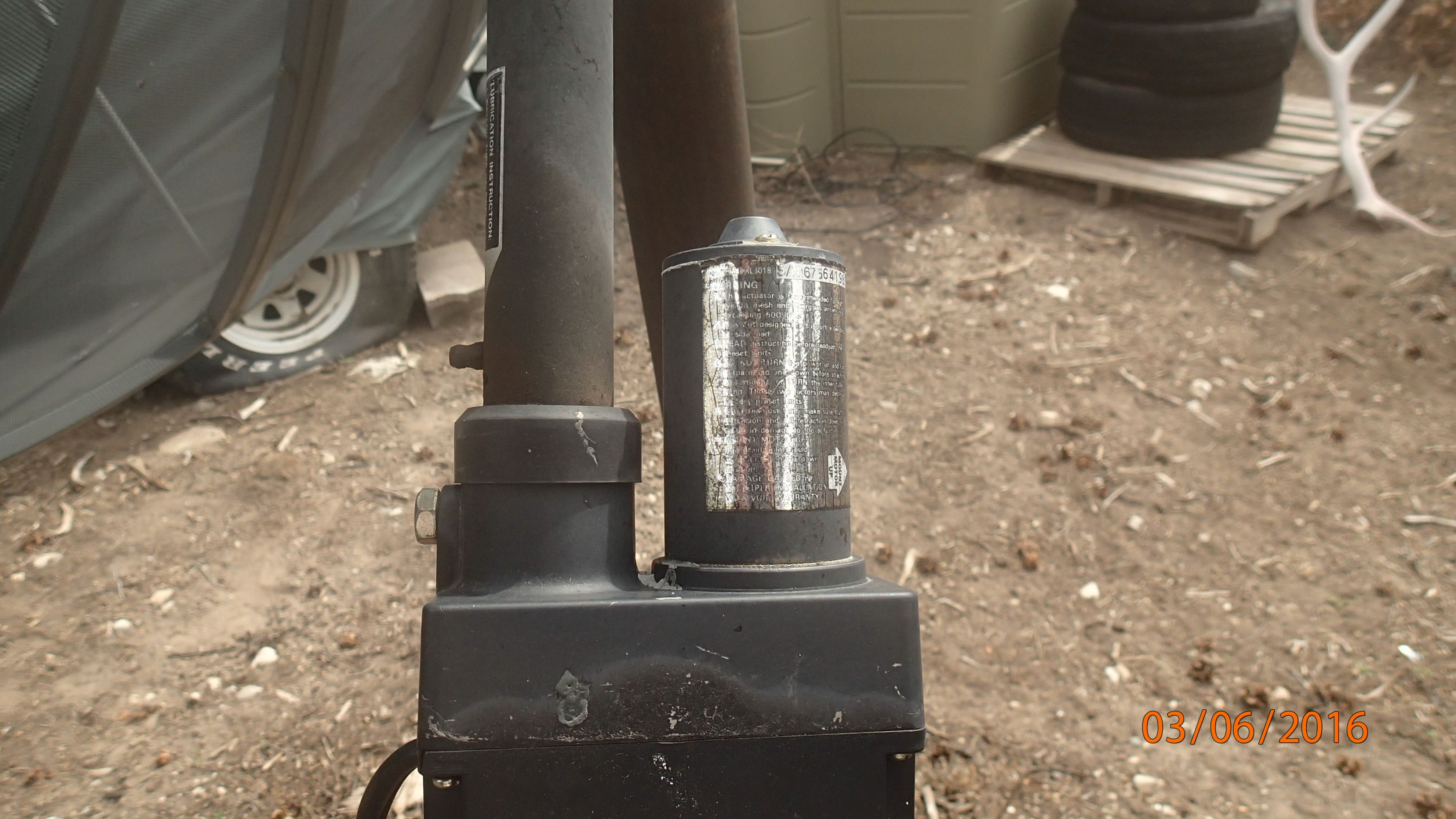

Before purchasing anything, test the dish motor. The actuator arm is usually the first thing to rust and freeze-up if not used. Lube the pivot points on the dish mount and spray lubricating oil in the arm. Let stand for a few hours or days if possible before applying power to the motor.
Remove the motor cover and use a car battery or charger to apply power to the two heavy gauge wires. Reversing the leads should reverse the direction of travel. If the motor works, this will be a considerable cost saving.

Yes, check and see if that motor works, that is the start.

Ok cool my car battery moves the dish both directions. Time to order some equipment a DVBS2 satellite receiver, motor controller, and a lnbf?

3. Change the feedhorn to a LNBF? For your ease of operation, I would swap the existing feedhorn with a LNBF like the Titanium Satellite C1-PLL. This will allow any DVBS2 receiver to change the polarity directly rather than using a servo polarity controller. Then you could use a GBox, VBox or ASC1 controller.
or
Keep the current feedhorn/servo as it will provide a better optimization and invest in the better quality ASC1 controller, which automates the servo motor control to work with any DVBS2 receiver.
