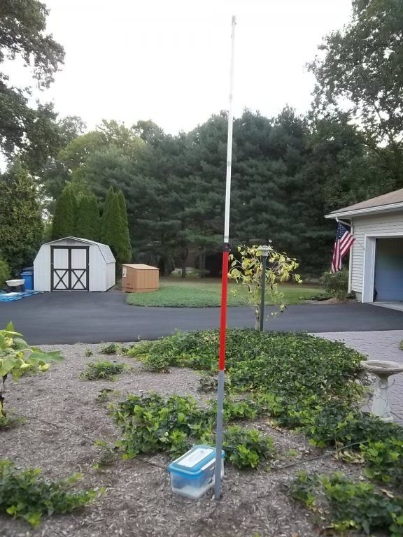

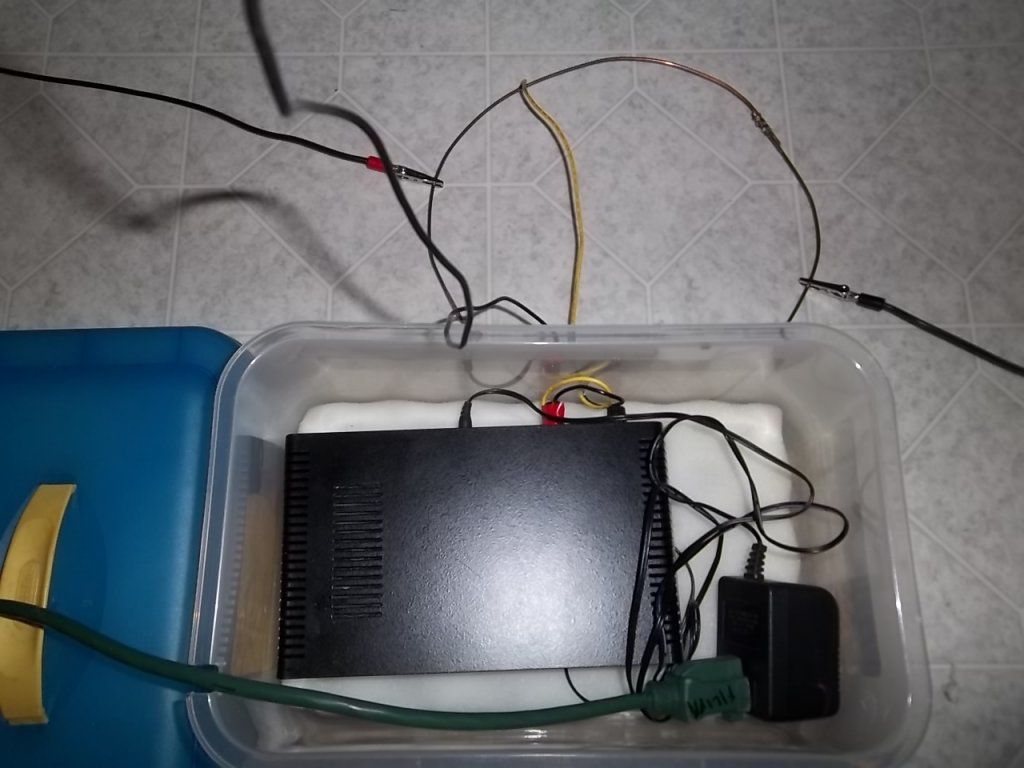

Set up this Part 15 TalkingSign transmitter, can be set from 1490 - 1690 KHz AM, it records a five-minute message that loops repeatedly. Antenna is a 3 meter wire attached to a fiberglass telescoping pole. Soldered a radial ring to the ground of the xmitter and ran two radials initially, got about 3/10 of a mile range so far. Next step is to try this with many radials to hopefully increase the range.These little xmitters are lots of fun.

I have a Hamilton Rangemaster and it gets out for about a mile and a half. I operate on 1620 am.
Mile and a half, not too shabby, that's what I'm shooting for. Is yours elevated, and do you use radials?
Was thinking of setting one of these up with a message regarding reception reports. Might get some long range reports in the winter, that is if anyone's listening to AM!
Mine is about 20 feet off the ground. (On top of my garage) with just a ground run down. We had to try a number of areas with the ground before we found a good spot.
