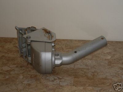

I just bought a used sg-2100 motor off ebay and it didn't come with a manual, so I was wandering how to find the motor angle? My latitude is 35.4358 north and my longitude is 87.3376 west, if that helps any. Also I looked at another website and it said my dish evaluation is 24.36 degrees, is that correct?

Here is a picture from ebay. I'm still not for sure which model it is. So I would rather ask and be sure, rather than just guess. It is a digipower sg-2100 motor. And it has one button that moves it from east to west. And it has a green light next to the two connectors for the lnb and receiver.

From the picture I believe it is a 30° post. Make sure you follow the instructions of 30°minus the declination = the dish elevation.
