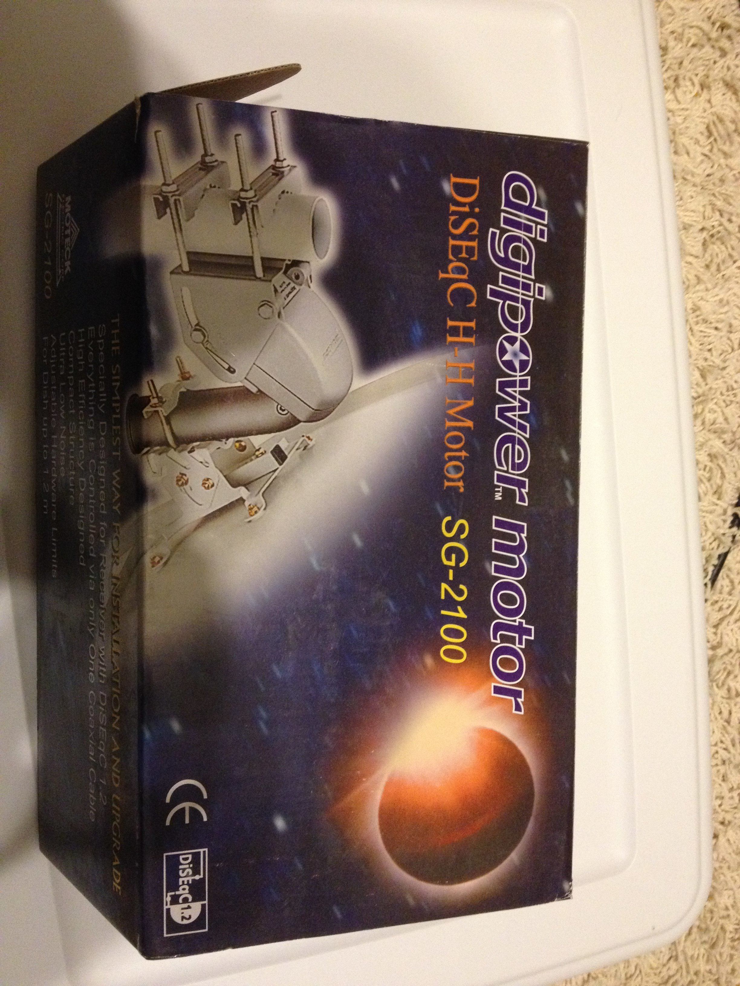

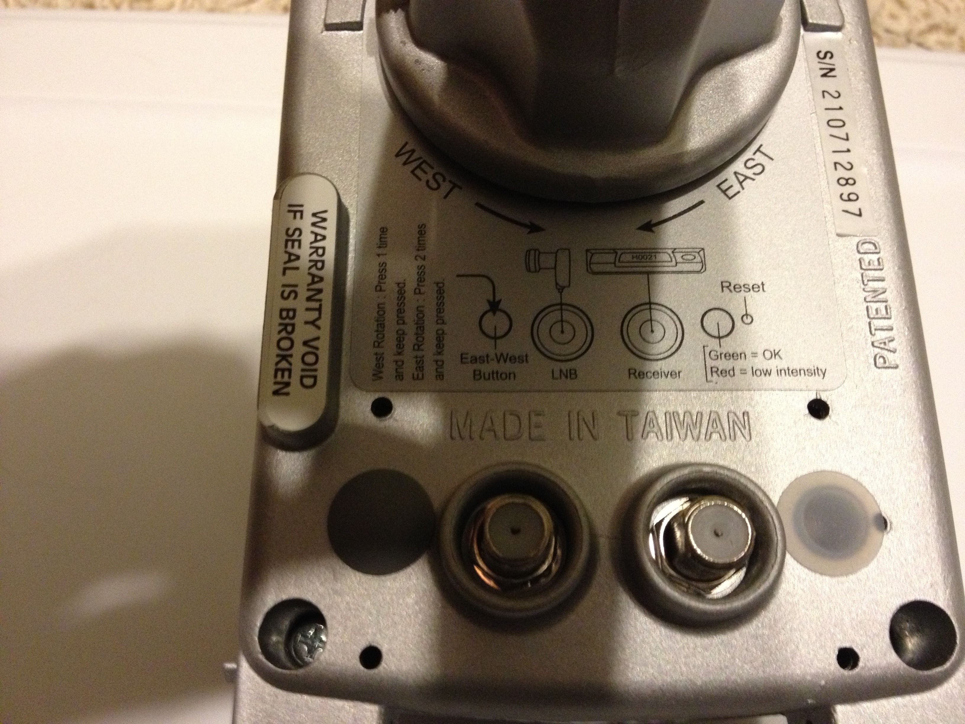

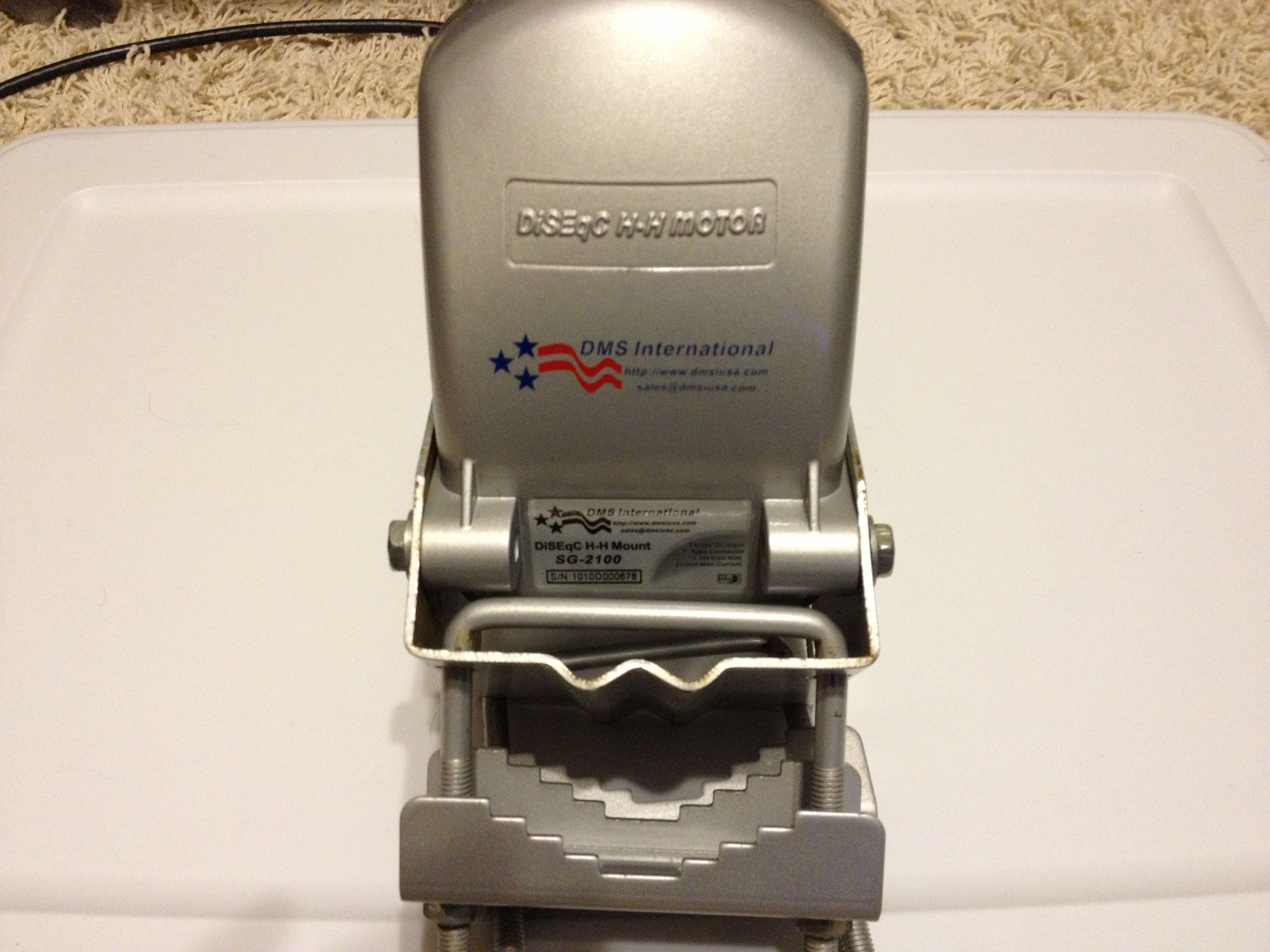

If you want an SG-2100 I would only buy the MOTECK digipower one. To the best of my knowledge the DMSI model was made in china and the other unit was made in taiwan.
I'm not picking on Tim I'm just telling what I feel is the truth.
Unit I would Pass On
