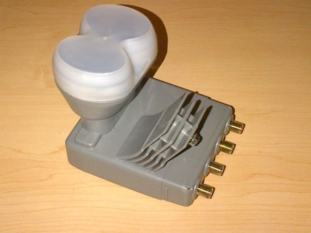

called shaw, they said it was bad multiswitch, because i couldn't get horizontal channels. so i bought a new quad [old style] LNB
still wont work. factory resets, shaw sent hit
i can get signal of 86 on channel 299 and a clear picture. green light. provider 4128 Sat A4
but if i go to channel 400, red light 4128 Sat A4 0 signal

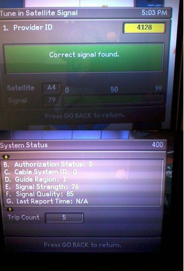

here are the actual symptoms:
power cycle DSR205
i can get TSN [400] perfectly for 3 minutes [see strong signal in pics]
after 3 minutes, the light flashes red / green/ red / green / red
no picture
no signal [no horizontal channels]
then i power cycle DSR205 again
no picture
