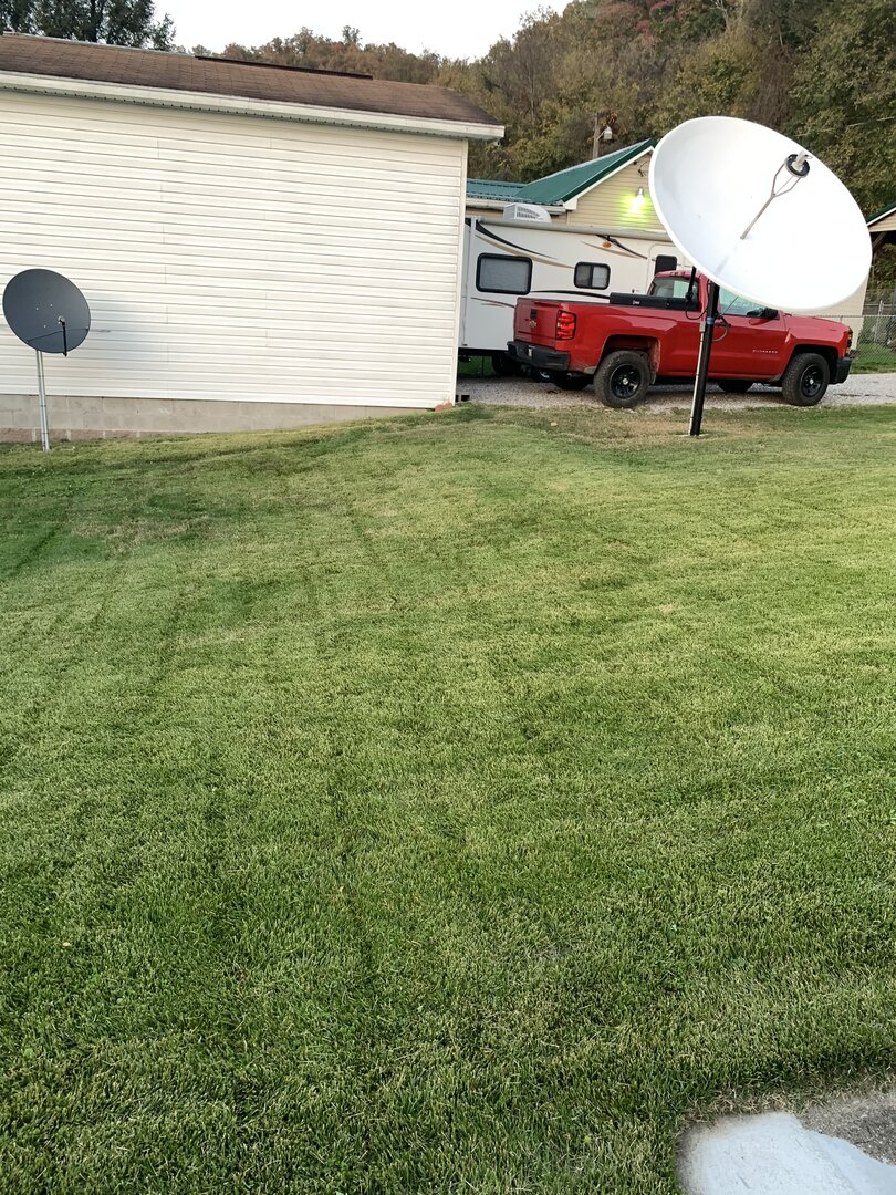

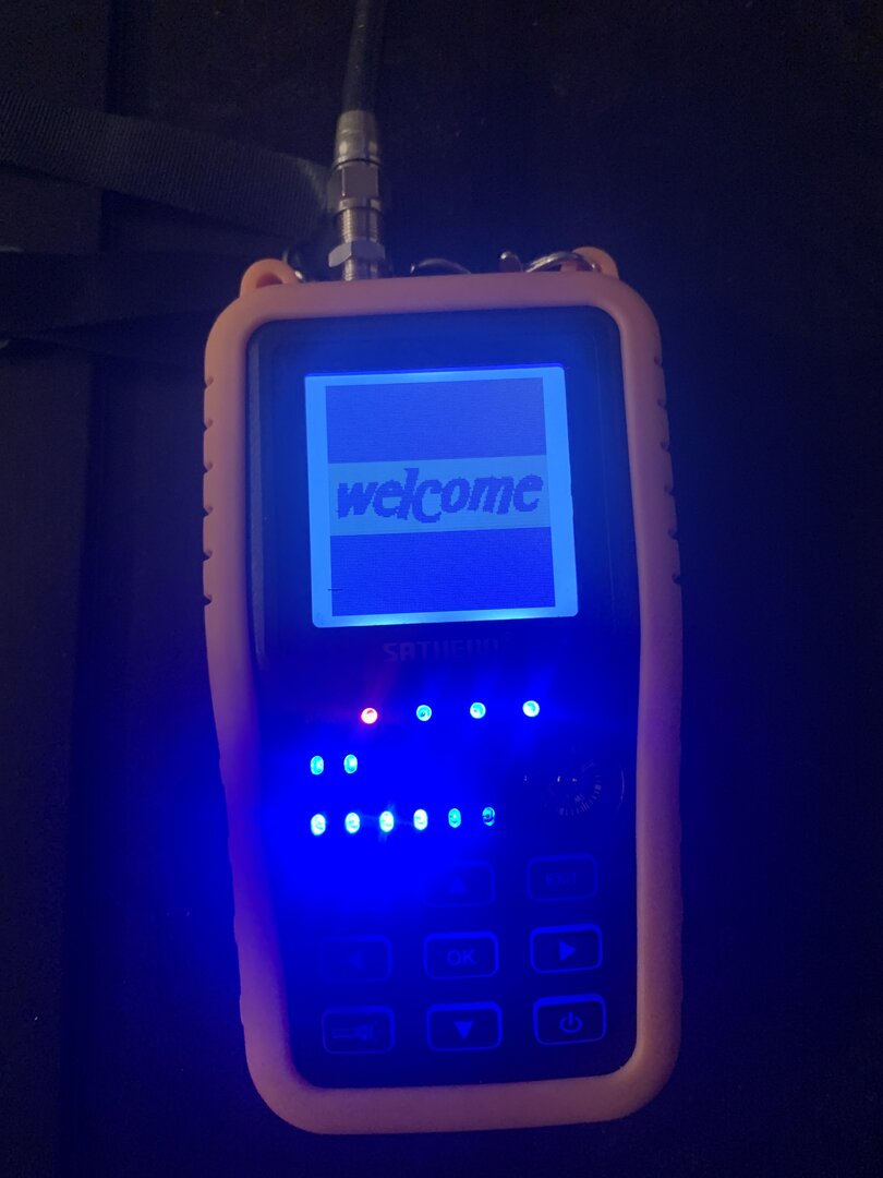

Team, first of all,
I would like to thank everyone who helped me get this far in the hobby. Here's where I'm at currently. After successfully setting up my diseqc switch and programing my receiver I'm successful switching between my KU dish snd C band dish on one Amico mini. Using the USALS location on my HH motor for the KU band dish I pulled in all available signals no issues. But with an actuator arm on the C band dish no USALS that I can use to my knowledge. So SATHERO to the rescue! Set all the parameters get the direction close then sweep back and forth till the quality peaks. Press blind scan and pull everything in. Again a big thank you to everyone who helped.

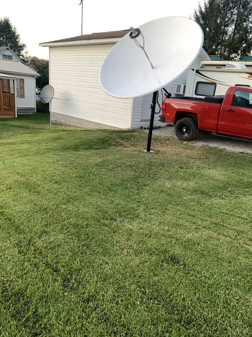

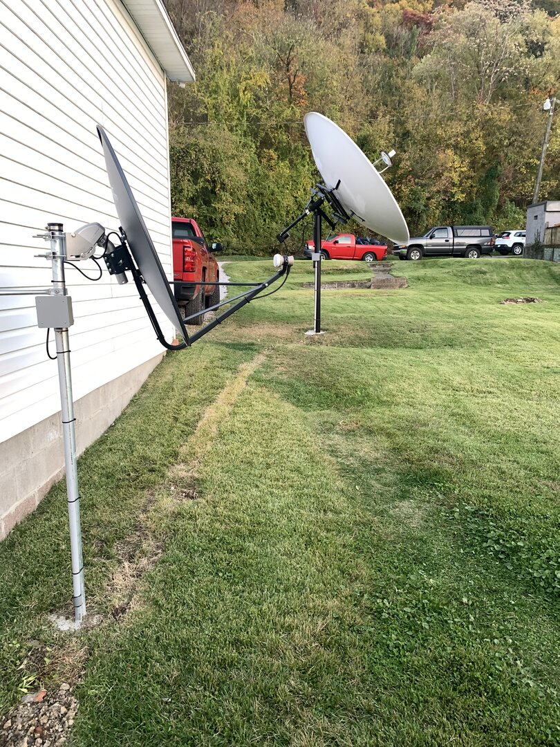

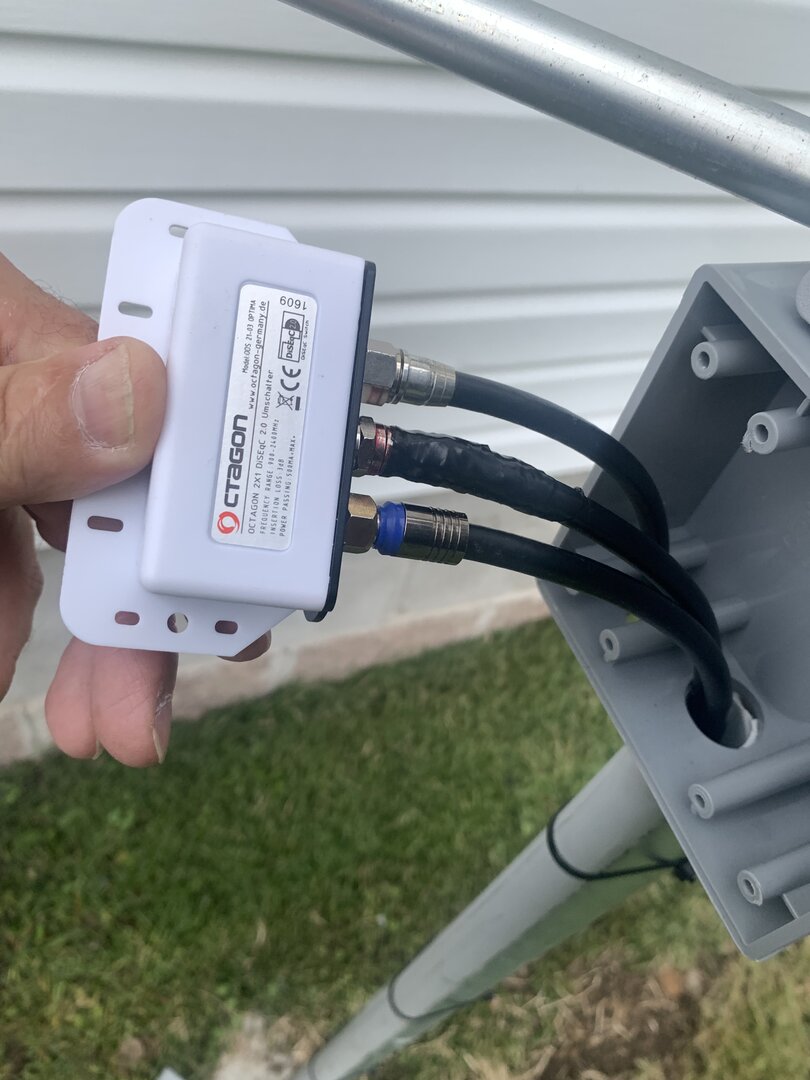

Team, first of all,
