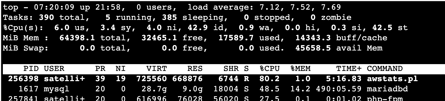

Took a quick look and found our state program AWSTATS stuck and causing issues.
I killed the process, so hopefully it will be better.
Ok I am here at work, and still not as snappy as I would like.
It appears the databse server is trying to repair the search index. The process list is showing
Repair by sortingREPAIR TABLE `xf_search_index`
I would like to kill it, but I am reading to leave it alone and let it finish. As killing it can cause other issues.
I am keeping an eye on it.
