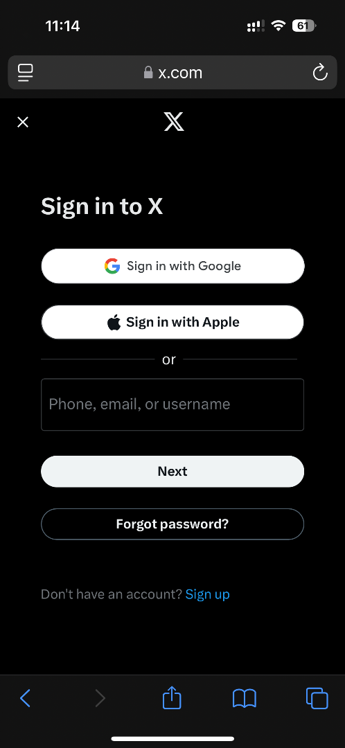

I don't believe you need a login for Twitter (they required it for awhile) Try going to x.com and see if you can see the posts without logging in.

No dice. Still requires an account to see your SG posts. Here is a screenshot after following your link:
