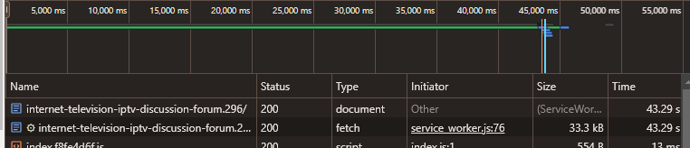

43 seconds for the initial request to return and then it all loaded, it did this a couple times before I opened inspector.

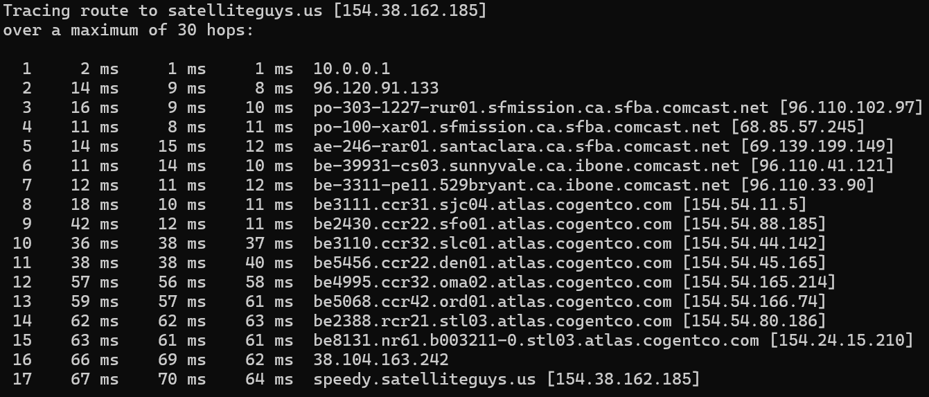

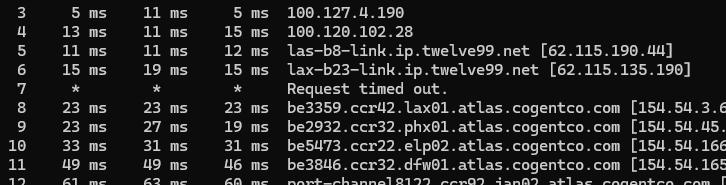

I do have a timeout on my tracert to satguys between twelve99 and cogent.
Doesn't really say much as the timeout could be intentional as they could block ICMP responses.... The reverse traceroute is important too which we don't have as the path it takes might not involved cogentco at all. Here is from SFO.
so using the above as a example, what does the route from SG to 96.120.91.133 look like.
I meant one can also have a reverse traceroute script installed on SG so the members can show the path back to them from SG as all we have now is the forward traceroute so with both we can see the whole picture. Here is a sample reverse traceroute script:
