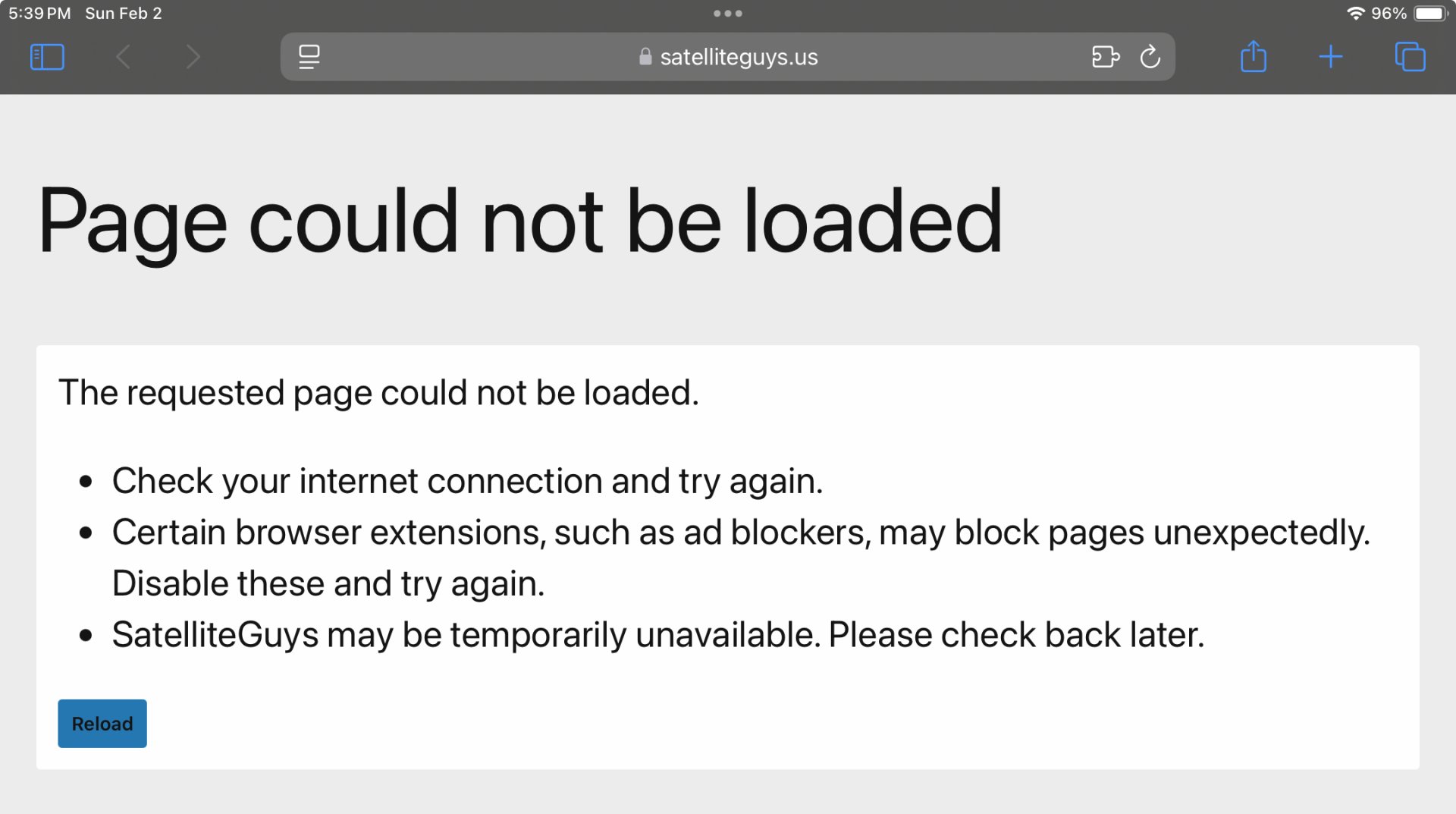

Site is slooooow
Like I said in the video I am wondering if there are issues at one of the CDN sites. This could cause some of the issues as well.
I actually purchased software which monitors the server from the server itself and that one does all kinds of system checks. And the last issue we had that it reported was the time they moved us to the server the other night.
And while everything is showing running fine I did get alerted of an outage at noon.
While another uptime checker reported no issues at the same time but is located in another location.
That to me would seem to indicate it may be a cdn issue.
I am out grocery shopping now. But when I get home I am going to disable the CDNs and serve everything (but the images) from this server. (If it's an issue at the image cdn server which only serves images then the images won't show)
Who knows maybe with this test it will show we don't need the CDn servers anymore. That would save us a lot of money if it was the case. :)
For what its worth some other sites have been slow. Not just SG.
And this could point to a CDN issue as well as many sites use CDN's.

Could be a CDN issue or it could be a peering issue as one way to know is from traceroutes both directions to see if there are problems only via certain paths. I mean for the people who see it as slow, they have to provicvide the traceroutes to SG and SG will have to show the routes back to their IP to see anything is showing high ping times, etc.
Ok got a note from the ISP that they finished moving us over to a new server at about 10:45 last night.
I am seeing MUCH better hard drive speeds of 542 MB/s which is better than the 80 MB/s (and slower) I was seeing yesterday.
One thing I did notice when searching for answers yesterday is our database is now on MariaDB and not MySQL, and looking at the config, the database server has not been optimized at all, its just a generic my.cnf file. So I may able to get some more speed there. Now to learn about optimizing MariaDB. :D
