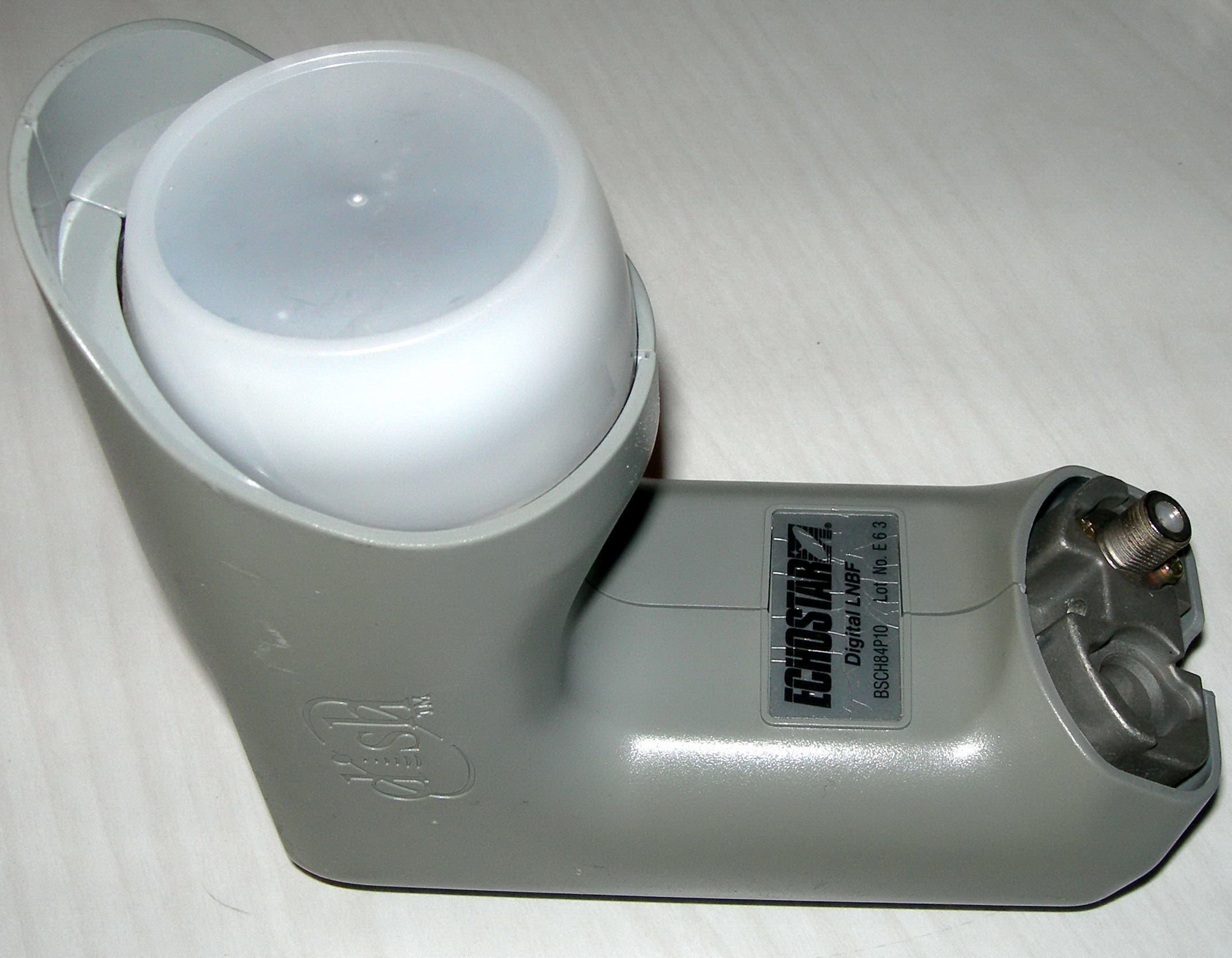

Twin LNB looks like the picture quoted below. It is quite wide.
Single LNB -- The Dual looks just like the attached picture but with a second connector at the bottom.
If you have a Dish 500 with a dual LNB, then the LNB may be off to one side or the other. This means you need to correct for that.
Also when aiming the dish at 61.5° you need to set the point dish screen to a dish 300. You then need to "offset" if the LNB is off to one side of the mounting arm
